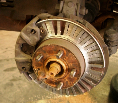

Trying to imagine how bad Dwight's rotors can be....
Attachment 19292
I don't think they would have to be that bad to cut through the wire. Not sure where you got that picture from. Probably someone racing the car and overheated the rotor really bad.
Again, why was I told I was wrong right off the bat?
I used reasoning and what I have read to deduce the problem.
Nothin' wrong with that. Its obviously a 'slotted' rotor.
