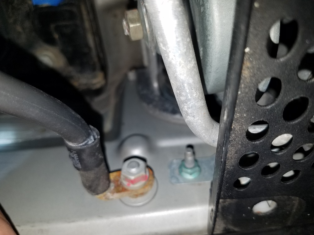

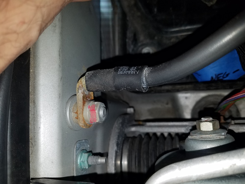

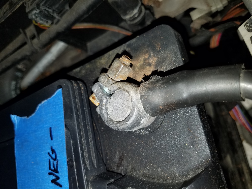

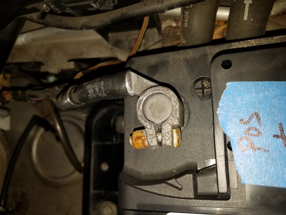

You guys are great....certainly all above my skill level but I am trying to make you proud. The multi meter is my weakest skill.....its all I can do to set it on volts...select 20.....red on pos...black on neg....and take a reading. When somebody tells me to ohm out something I immediately want to take a nap....does not compute.
Soooooooooooo I know i said I was gunna perform all tests......and was gunna make you proud but this is what i did tonight.
I finally found a fricking mini light bulb that would work for my tail light side marker....that was 3 days of my life i will never get back. I believe it was a Name:  pbatt2.jpg

Size:  261.3 KB 2528....so glad to see that sucker all lit up. I am now a 986 taillight expert...I can get those fixtures out of there with pit crew speed.
Then I went to work on my 3rd brake light....the previous owner had really worked this thing over. It was loose....not mounted because the body grommets were missing ...most of the brittle plastic clips were broken and two bulbs were out. I got it out...replaced the bulbs and have it back in better then before but wont be happy until it is bone stock perfect......so off to ebay or the for sale section here for a 3rd brake light and some body grommets. At least it works and will get me through local inspection which I need to do very soon.
Lastly I attacked the battery.....I took a quick reading and it was 12.3 ....I decided to remove it completely so I could clean contacts and grounds. The battery is fairly new....April of 2017....but you never know what shock or drain a battery has had. I figure I will take it to Batteries Plus and have them hook it up to their load machine.....and see what CCA it produces...etc Either way I like to start my used cars off with new batteries so I have a good base line. Now if I hook up a new battery and it drains to 12.3.....thats how a dummy like me knows there is an issue! As mentioned before the negative battery cable where it attaches to a body frame stud looks rusted....I also notice the shrink tubing is loose so moisture or salt air could have corroded wires under it. I will thoroughly clean this connection and inspect the condition of the wires then install new shrink tubing and some dielectric grease just to make u guys proud.
Pics tell the story better then I do....so enjoy the pics....batt terminals not bad.....but neg batt stud....not good.

Yup cleaning up that ground connection will be a good thing.
Good thinking on the battery load test idea. Best way to see if it is good or bad.

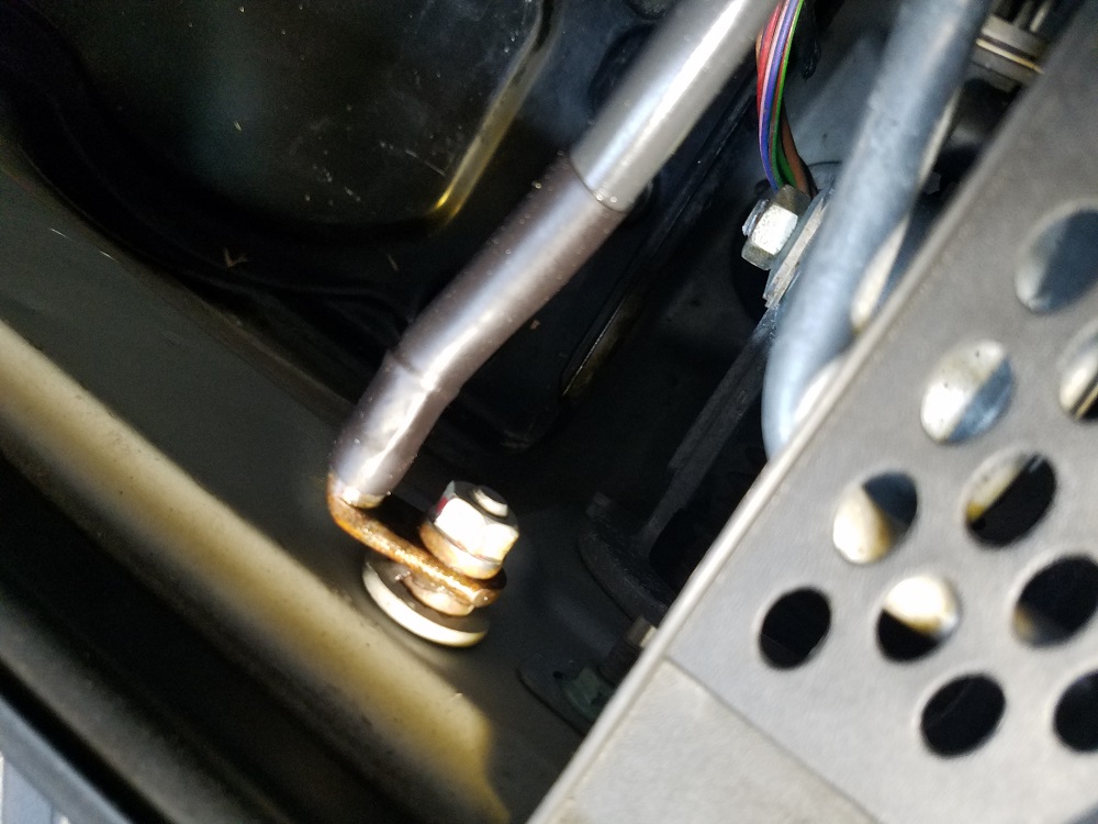

Took the battery to auto zone....Its a brand new store in my neighborhood so everything is clean and perfect.....to include the shiny new battery testing machine....that thing must cost $1000 dollars. The kid didnt give me much info other then it was at 12.55 volts on his machine......12.47 on my multi meter.....I even changed the battery on my meter but no change. I guess I will go with what the $1000 dollar machine said. He said the battery was good. So tonight I cleaned up the negative body post..removed the shrink tubing and inspected.....found zero issues with cable wires....cleaned up a bit added some dielectric grease and shrunk a new boot on. Im not really believing this post was my issue...but gotta start somewhere and it did need to be cleaned up.
I bought a 3rd brake light for $30
OEM starter for $65 had 70k miles on it......
Both from ebay last night.....let the spending begin!!!!!
See the before after on the body post....I will be crackin into that engine bay tomorrow...I cant wait to see it....yet with 158k I am very apprehensive...really dont want the spending to keep going and going and going.Name:  Pbatt1.jpg
