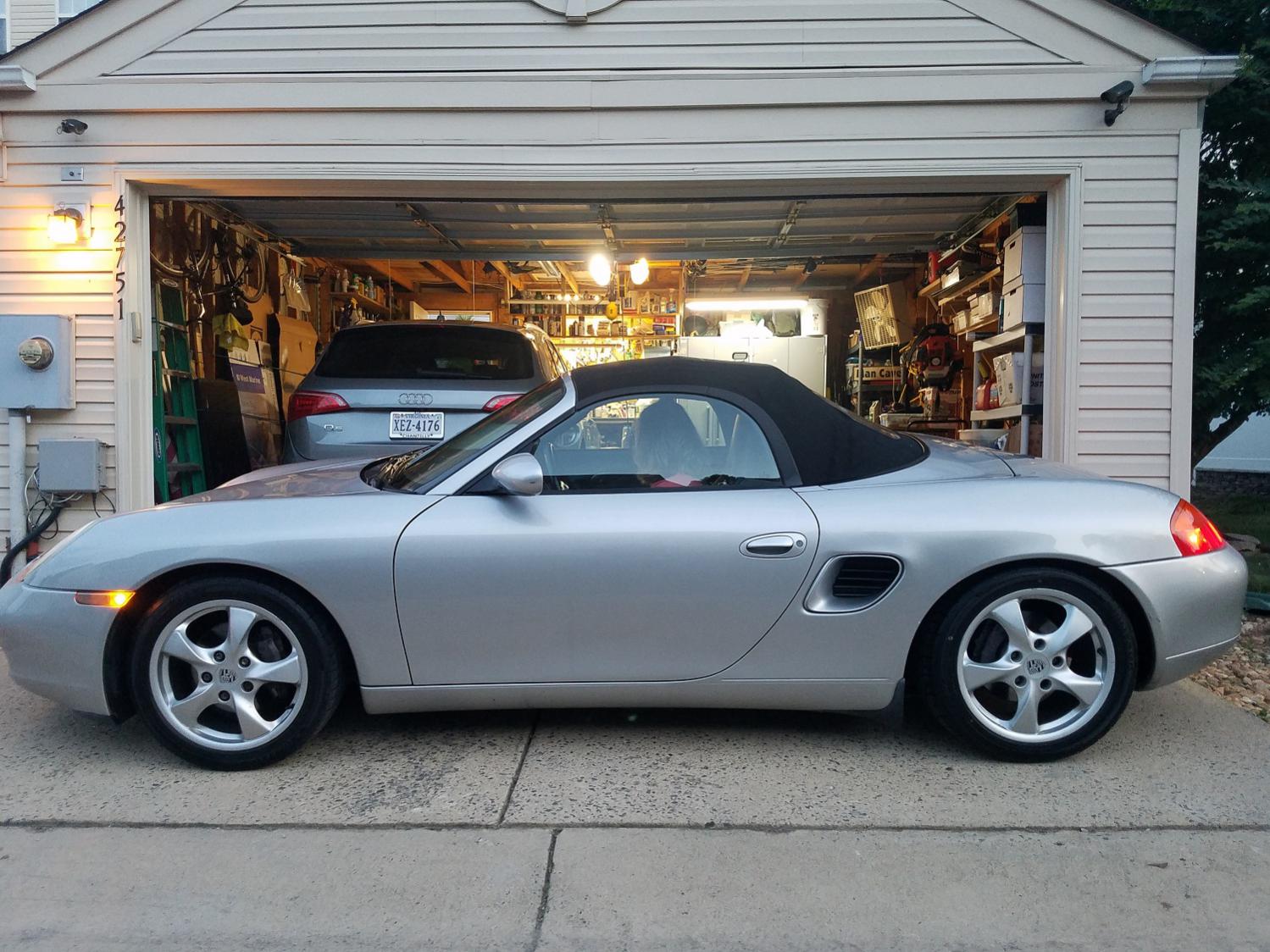

Posts: 78
checking to see if I can load pics
Box7774 is offline   Reply With Quote
