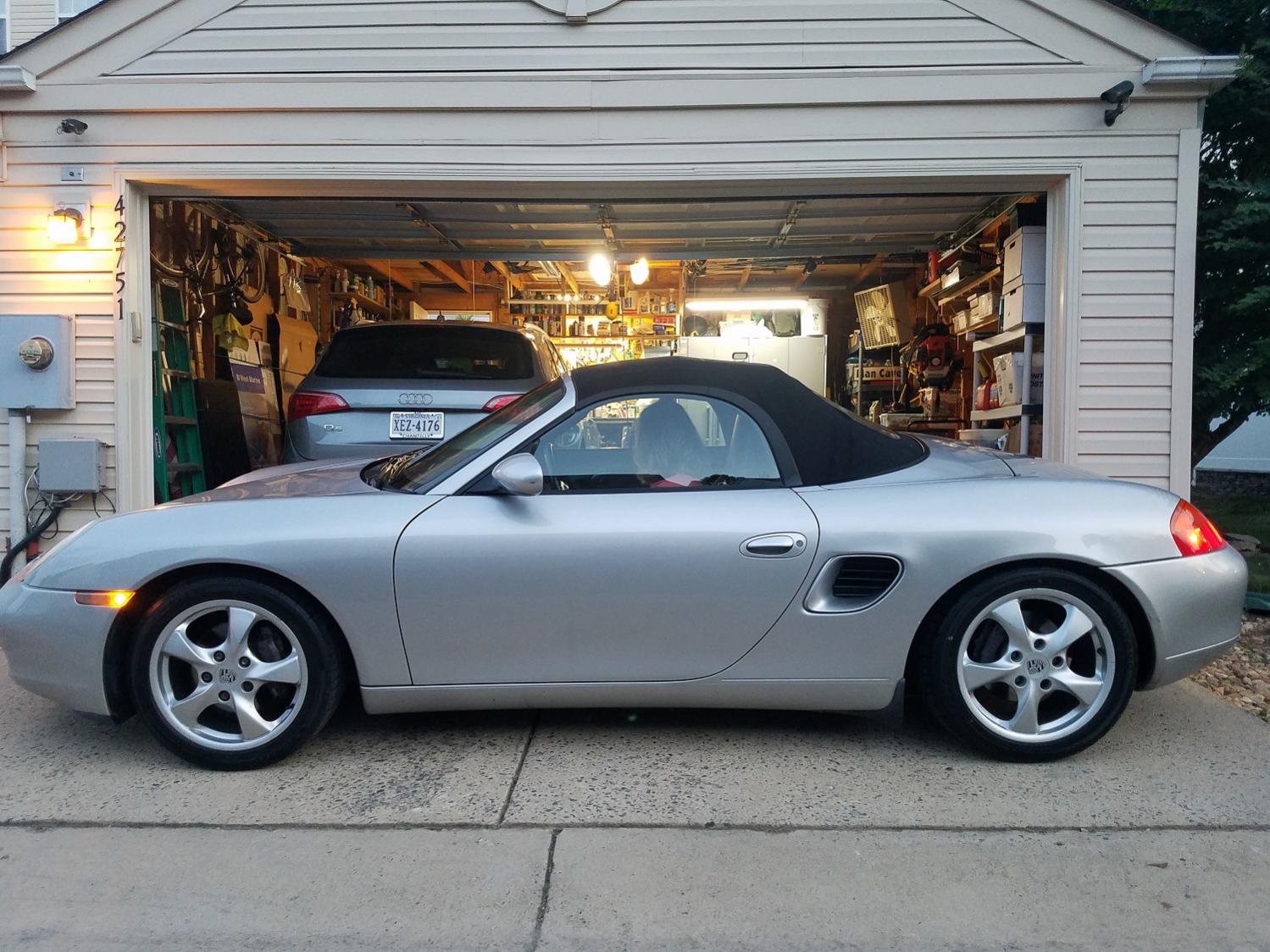

I was going to start a new thread for this question but i will ask it here first. So here in Va its a gorgeous night so I couldn't help myself and took the new to me 986 for a zip around. Wow that little car pulls pretty hard and sounds great! That was the first time that I have tacked her up and she did not disappoint. The top goes up and down with no issues but I am noticing that after I put the top back up and exit the drivers door.....when I shut the drivers door the window hits the outside of the top frame....am I doing something wrong? I can manipulate it a bit and get it to shut within the frame and seal correctly but it would be better to see the window go down 2" when I get out of the car and shut the door.....then go up after I have shut the door....if that makes any sense.
Box7774 06-23-2019 06:05 PM
Attachment 21965
checking to see if I can load pics

Very common issue. The window should drop slightly. Do a search on the forum.
