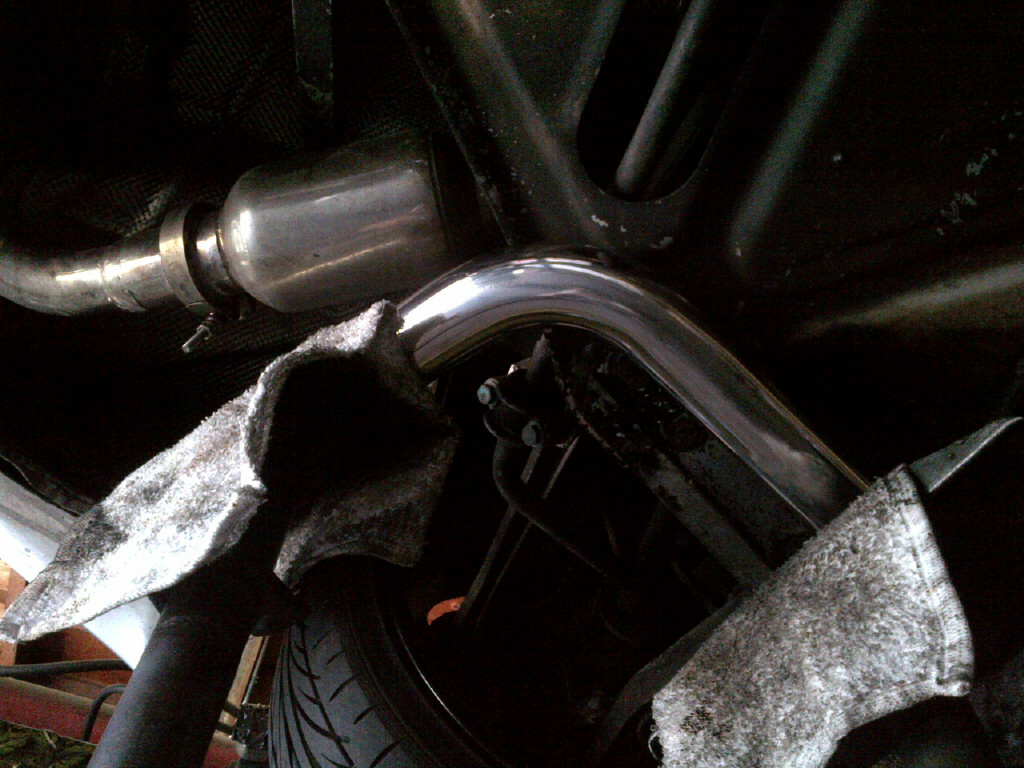

I have a 03 Boxster S and here is my problem.
After I received my order on Friday, I took the box straight to an exhaust shop to get it installed.
The first exhaust shop said the angle and shape of the piping was incorrect, but I wanted a second opinion because it was a small mom and pop shop and based upon reading the forums, I knew there would be some slight modification that needed to be done.
So today, Saturday, I took it to another shop to get their opinion. Again, they said there is no way these pipes will fit. There is 2 problems with these pipes. The angle of the pipe is incorrect and also the shape of the pipe is also wrong. If you look at the stock setup on a 2003 Boxster S, the pipe from the primary cat to the exhaust should angle upwards towards the trunk, top speed's pipes are nearly flat with only a very slight angle at the flange.
The second problem is the shape is also wrong. See attached pictures. When it's lined up with the factory flange, the end of the pipe is pointing towards the end of the bumper.

My confidence is fading. While the pipes are reasonably constructed, it means little if there not properly designed. I was concerned from the outset given the feedback of other buyers. While I don't know the exhaust system well enough to say whether mine will fit just from looking looking at the pipes, but I will say that the angles look quite sharp compared to my mental picture of the rear pipes. Stay tuned...

I fitted a set of test pipes to my 2001 S Boxster last January with no problems at all. After saying that, I had fitted Che's headers a few weeks before, again with only minor adjustments to the fixing holes (they were slightly too small). I cannot comment re fitting the pipes to the standard headers.
However, when fitting the pipes, I started off loosly bolting the flange on to the header section, but no way could I get the other end of the pipe lined up with the muffler. The secret is to push the test pipe into the muffler and THEN adjust & connect up the 3 bolt flange end, pulling up the gap slowly & evenly with the bolts.
Of course, there could still be a problem with your particular pipes (or the wrong ones ordered / sent), but I must say I am very happy with my purchase from Che.....

You are correct, the two pipes are different lengths - as are the Porsche originals when you remove tham and look at them side by side.....
sb01box...
When I fitted the test pipes, the gap between the 2 flanges was quite small say 5 - 10mm (1/4 - 1/2") which pulled up easily. I guess if I had pulled and pushed the pipes out of the muffler entry by hand, I could have possibly closed the gap - as it was I was tired and just used the 3 bolts to slowly pull the flanges together.
I rechecked the bolt / head stud tenioning last month after 3,000km and there ware no signs of leaks, cracking or metal fatigue that I could see.

my concern, after reading this and "other" thread is that the angles were off. in your case it sounds like the pipes were little short, but the header flange and the pipe flange were parallel and needed to be brought together.
the "suspension" that the muffler attaches to should allow for forward movement of the muffler to accommodate 5 to 10mm gas.
were the gap the same on both sides?

looking at your very first photo, it looks like you have two left sides. I arranged the pipes just like it is in your photo and I can only get this. see how the top pipe's flange is resting on the side, but the other pipe is resting on a tip of the flange.
when I arrange my set with the tubes flat and with the end pointing away from each other, a side of the triangular manifold flange is almost flat to the surface. I believe once installed, a flat feature of the flange is the bottom most part of the connection.
I've been doing some additional look-see. (measured, but very subjective.)
1) since the pipes are "symmetrical about the engine, you can check for symmetry.
2) resting the bottom side of the flange on the table, and with carpenter's level on the surface of the flange, proping up the pipe end till the flange was vertical, the bottom of the pipe end was 3-3/4 and 4.0 inches above the bench
3) with the pipe resting in what will be it's installed orientation, see photo above, the measurement from the top tip of the flange to the top the middle of the pipe end was 20 inches for both.
