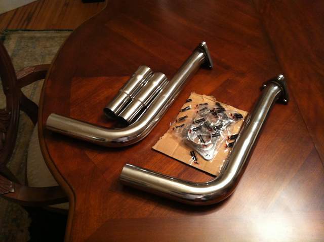

shadrach74 09-22-2012 09:21 AM
Top Speed Bypass pipes initial impression
My bypass pipes arrived this week for $189 shipped. I will drop them by my shop while they do the RMS, IMSB and other work this week. I plan on doing a dyno test in the future to see if there is any difference at all... My primary reason to install these is weight savings as well as removing a major heat source (secondary cat) from the vicinity of my CV boots.
This kit includes the pipes, gaskets, clamps, and other hardware needed for installation.
http://986forum.com/forums/uploads01...1348328911.jpg
http://986forum.com/forums/uploads01...1348329074.jpg
The quality of the materials is as good or better than I would expect for this price point. There are some marks from the manufacturing process as well as some minor pitting here and there, but for the money, I think the materials are satisfactory.
http://986forum.com/forums/uploads01...1348328644.jpg
http://986forum.com/forums/uploads01...1348328684.jpg
http://986forum.com/forums/uploads01...1348328841.jpg
http://986forum.com/forums/uploads01...1348329007.jpg
The quality of the welds appears to be adequate. While the finish could be a bit better, we are talking about less than $200 here, I am pretty happy with it.
http://986forum.com/forums/uploads01...1348329317.jpg
http://986forum.com/forums/uploads01...1348328496.jpg
http://986forum.com/forums/uploads01...1348328555.jpg
http://986forum.com/forums/uploads01...1348328592.jpg
The proof will be in how easily it bolts up to my 3.2. I will report back as things progress!
Cheers!
Ross

shadrach74 09-22-2012 04:37 PM
My confidence is fading. While the pipes are reasonably constructed, it means little if there not properly designed. I was concerned from the outset given the feedback of other buyers. While I don't know the exhaust system well enough to say whether mine will fit just from looking looking at the pipes, but I will say that the angles look quite sharp compared to my mental picture of the rear pipes. Stay tuned...:confused:

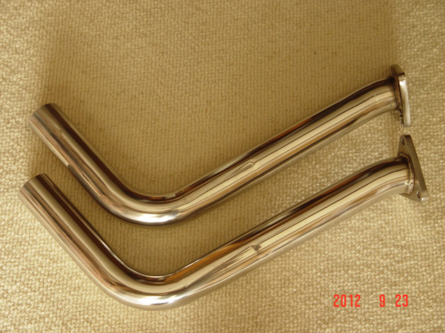

sb01box 09-23-2012 10:57 AM
Originally Posted by shadrach74 (Post 307015)
My pipes are not identical. They appear similar, but they are certainly different. This is not to say they will fit, but I'm going to reserve judgment until we attempt to match them up to the car. Why would you try sell them as opposed to sending them back? At that point you're just kicking the can down the road to someone else. If mine don't fit, Che will be the first to know and his handling of the situation will be detailed here. Similarly, if they do fit, I will also detail the particulars here.
Shadrach74,
looking at your very first photo, it looks like you have two left sides. I arranged the pipes just like it is in your photo and I can only get this. see how the top pipe's flange is resting on the side, but the other pipe is resting on a tip of the flange.
http://986forum.com/forums/uploads01...1348421243.jpg
when I arrange my set with the tubes flat and with the end pointing away from each other, a side of the triangular manifold flange is almost flat to the surface. I believe once installed, a flat feature of the flange is the bottom most part of the connection.
http://986forum.com/forums/uploads01...1348421404.jpg
I've been doing some additional look-see. (measured, but very subjective.)
1) since the pipes are "symmetrical about the engine, you can check for symmetry.
2) resting the bottom side of the flange on the table, and with carpenter's level on the surface of the flange, proping up the pipe end till the flange was vertical, the bottom of the pipe end was 3-3/4 and 4.0 inches above the bench
3) with the pipe resting in what will be it's installed orientation, see photo above, the measurement from the top tip of the flange to the top the middle of the pipe end was 20 inches for both.
I need to stop playing with them and start the installation
