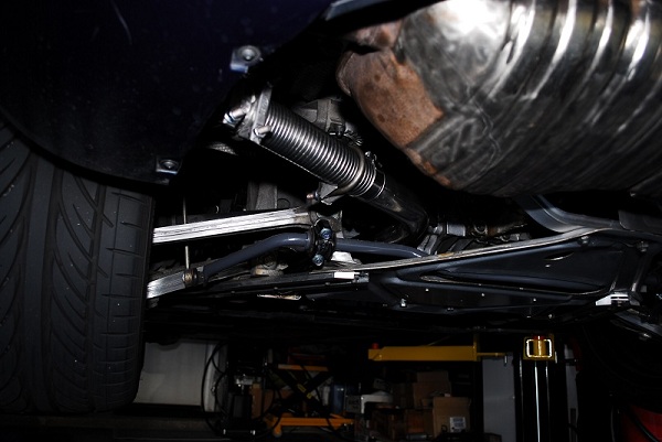

Some bypass pipe fitment issues and a workaround...
Received a left and right pipes from Top-Speed with no issues. Overall quality appears to be good. However like others mine did not fit as well as I was hoping. I had to do some mods. Some of the proper fitment was hampered by the exhaust modes already done to the car before I bought it. I think it's called a Pedro exhaust mod etc... The Pedro mod has the 1" pipes welded to the U tubes and not the muffler inlet. So, they were unmovable, otherwise I might have been able to tilt the U tubes down for a better fit with the hardware received in the pipe kit.
I wound up using 1 3/4" ID x 2" OD reducers and 2" stainless flexible muffler pipe to get everything to work and to assure nothing was overstressed. I don't particularly like muffler clamps and bendable pipe for exhaust mods but check out the pics below. It's a solid fit and there are no leaks. I'm running stock manifolds with pre-cats.
I don't have the car off the rack as yet but did start it up and it sounds good.
