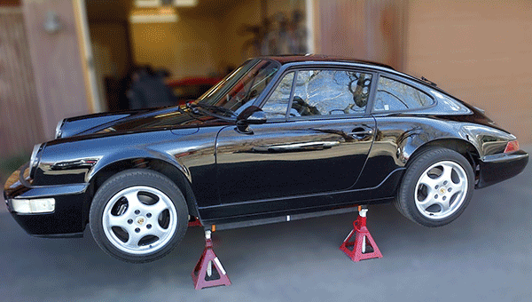

I'm sorry guys, but jacking up these cars using a point that was never meant for such a purpose can be both dangerous to your health and wallets. There are four points built into the car that are designed for lifting the car without becoming hazardous to you or the car's health. There are also companies like Lift Bars that make excellent units that utilize the factory lift points to quickly get the car up high and rock steady on jack stands by lifting the entire side of the car in one motion.
Having lost a friend to improper jacking of a car, and also having been called upon to repair damage done by improper jacking, don't cheap out or try to find short cut; it could end up being one of the most expensive ones you ever take.

Then look into the Lift Bars I mentioned, well made and very stable with the car up high:

Thanks. We have no interest in the company that makes these, but saw them in use at the track and thought there were both well designed and well made. We purchased a set several years ago and have very impressed with them.
