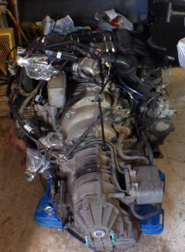

The proof of the pudding! (Okay, so it took me a while...)

Dropping them together is not that hard, although you must remove the cross member ( no sweat really). The real PITA is that there's a shiftload of extra hoses and wires to deal with. After I'm finished the engine work, I'm seriously considering loading it onto a flatbed and having a local shop stuff it back in. But maybe when the time comes... I am a cheap bastard after all
