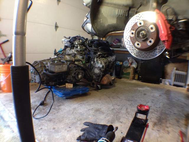

Old 03-11-2014, 01:20 PM   #12
Artist, 986S tinkerer
NewArt's Avatar
Join Date: Aug 2013
Location: Montreal, Canada
Posts: 1,821
The proof of the pudding! (Okay, so it took me a while...)
Old 03-11-2014, 01:42 PM   #13
NewArt's Avatar
Join Date: Aug 2013
Posts: 1,821
OMG, where do I start ?!!
