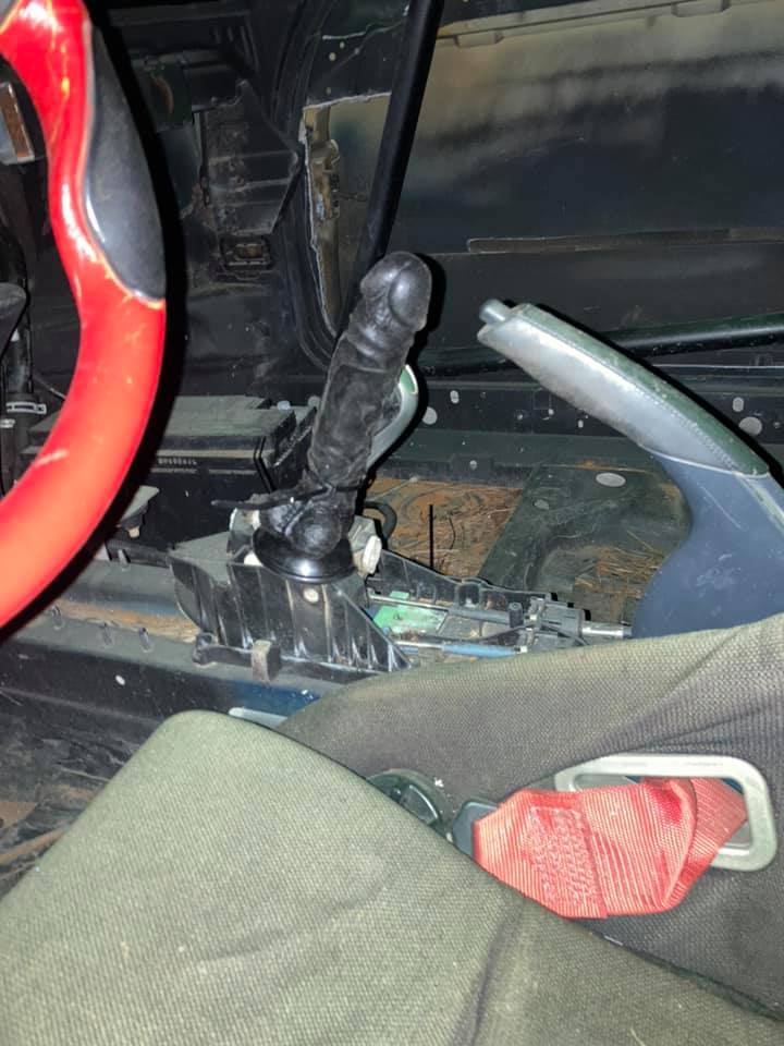

I forgot to add one picture. The guys thought I could use a new shifter on the boxster and added this one. I was afraid to shift it too much and took it off before the race
Woody
