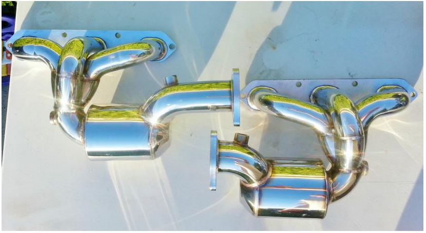

Old 04-09-2019, 09:56 AM   #34
Join Date: Dec 2016
Location: Clifton, NJ
Posts: 1,135
this may help anyone whose confused...ahem

I'm not the least bit confused, thus the reason I bought the headers I have. To retain the O2 sensors and have a cats in the system to help on polluting the air, plus they are needed to pass inspection. I didn't pay $1,200 for a set of headers because I like to waste money.
2003 Boxster S
Old 04-09-2019, 10:50 AM   #36
Join Date: Dec 2016
Posts: 1,135
yes you are, because you are talking about how tuners delete primary front 02 sensors to make the car "more responsive", which is total bs.
Can't admit you were wrong, huh?
I'm wrong. The front O2 sensors do have to stay. Yes I can admit when I'm wrong.
2003 Boxster S
Old 04-09-2019, 12:17 PM   #40
Join Date: Dec 2016
Posts: 1,135
Cool, no biggie.
Now as to your coolant temps, i cant offer any explanation why plugs would cause this temp decrease.
