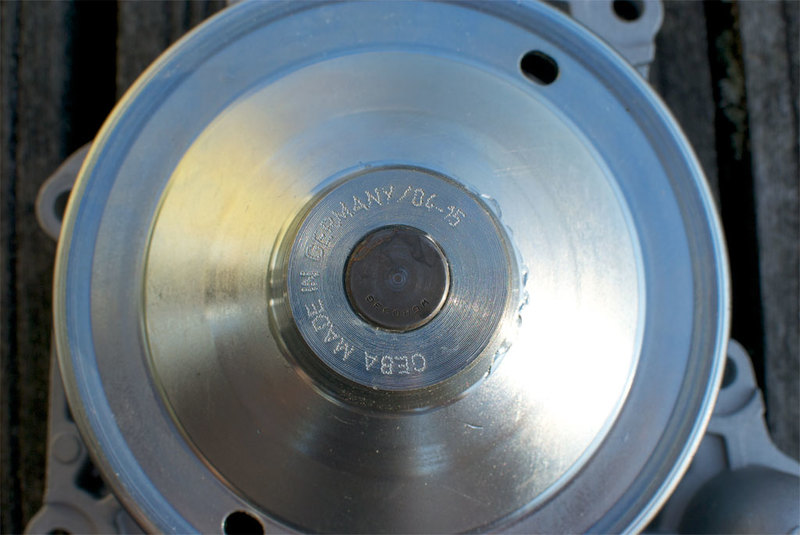

Not to start a ruckus but this is why I prefer metal blades to plastic.Yes, you need to check the w/p bearings regularly but I would do that anyway. As this thread indicates ,dismissing metal blades because the plastic ones do not abrade the crankcase half is only a part of the issue and open to rebuttal. Distributed broken plastic impeller blade parts cause different but expensive problems.
I do so wish Porsche had waited a little with the M96 and just copied/scaled up the Honda Valk flat 6. Lancia Flavia, & Subaru.
If you did that with a plastic one -- you would never have a problem either -- and in case of failure, you wouldn't have to toss the block.
I've seen the damage a metal blade causes.... not good.
I've also seen what non-OEM WPs have done -- had 2 die on me <1000 miles on two different Boxsters.... never again.
YMMV, but I'll stick to OEM plastic.

I'll do the metal one.
And i'm not afraid to do, beause i know what i do and why i'm doing it. But i don't want an endless discussion with people who don't understand the why. Only thing i can say is that you never put a metal impeller one in an engine where a plastic one has failed – NEVER! Also very important: there is a GT3 and a non GT3 version. And they are different!
