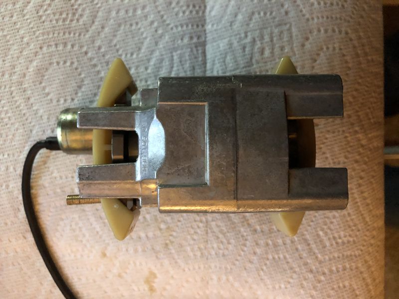

After I obtained the metal washer for the compression tool I managed to get the VarioCam out — not without some difficulty, but any victory's a good victory.

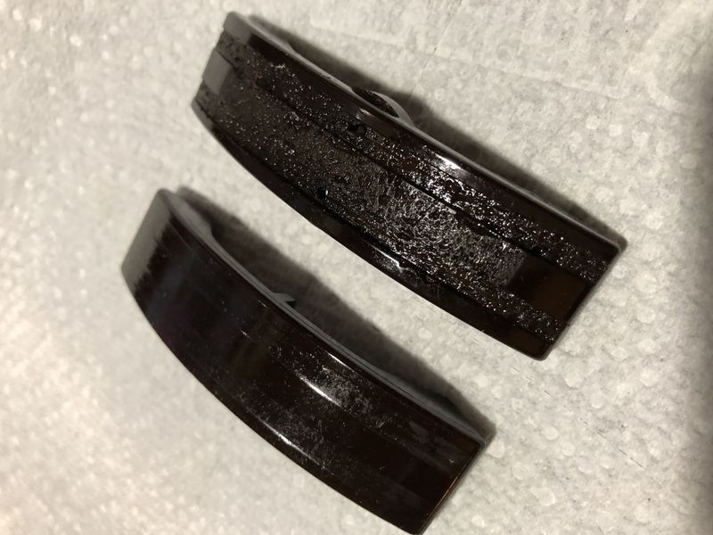

The bottom pad indeed had considerable wear, no doubt enough to cause some cam deviation:
I snapped the new pads into place (after carefully inserting the o-ring under the bottom pad). Note the new material's lighter color.
After an hour of trying to reinstall the VarioCam between the camshafts without success, I tightened the compression tool's nut a few more turns (using my little box-end wrench) to get a bit more clearance. However, the nut didn't seem to be moving on the rod. So I removed the tool, and then I saw the reason why — the threads had stripped. The compression tool seems to have been made of soft metal. You can see the spot about 3/4" from the end where the threads are flattened. The nut just spins at that point.
Addendum: I was using a small 8mm box-end wrench, not a ratchet, and it didn't take all that much force to tighten the nut. I've stripped threads before and it usually requires considerable force, unless the metal's soft. I'm going to contact the aftermarket parts company's customer service department and see what they have to say about it.
Surprise! Yet another oddball work stoppage! And the $36 I paid for the compression tool is down the drain. That's bad enough, but I'm dead in the water until I get another compression tool. Time lost.
I was crossing my fingers that things would go smoothly from here on in, because I'm working under a time crunch: I need to have the car on the road by the end of May, because the owners of the house I'm renting are putting it on the market. I bought another house, but I hoped to finish the car here and drive it to my new place. The logistics of moving a half-finished car and another engine would be a nightmare.

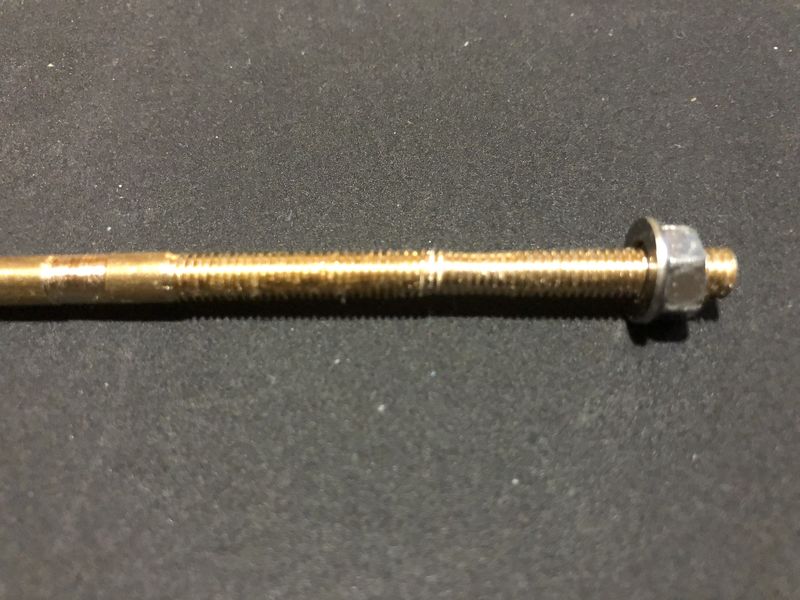

Post mortem: The most likely way thread damage could occur in the middle of the rod is by tightening it to the limit of compression and then continuing to tighten it. But I was aware of the warnings not to overtighten it or risk breaking something on the VarioCam. I estimated the unit was compressed no more than 90 percent, judging by the tautness of my chain compared with the laxity of chains in videos I've seen. If I had reached the compression limit, I'd think I would have felt some resistance, more than when just tightening the nut. Perhaps the progressively increasing force required to tighten it was just too much for soft threads to handle and they gave out. That said, I have to acknowledge the possibility that I overtightened it, despite being very careful not to. Regardless of the cause, I'm going to need another compression tool. First, I'll see what the company that sold me this one has to say.

More proof the compression tool was made of soft metal and therefore the defendant is not just a careless idiot who overtightens things. If it please the Court, I present the following photograph as Exhibit 1:
Note the 6mm wide, 1mm deep channel in the shaft near the threads. The nut was full of metal bits from the damaged threads and therefore difficult to turn, so the defendant used a pair of small vice grips to hold the shaft. Apparently, the vice grips weren't cinched down enough, so they carved the channel during a single rotation of the shaft. A channel of this depth could not be created so quickly unless the metal was soft.
And so, ladies and gentlemen of the jury, I submit to you that this entire fiasco resulted from too-soft metal and therefore LoneWolfGal is innocent of boneheaded workmanship.

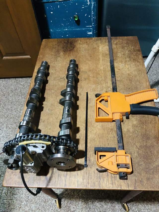

I couldn't stop fiddling with the cams while waiting for the replacement compression tool to arrive, and I was struck by a Grant Hargraveish idea. First, I used a carpenter's clamp positioned on the new pads to fully compress the VarioCam. (And a C-clamp would have worked just as well, but I didn't have one large enough on hand.) Next, I threaded a heavy-duty pull tie through the holes for the compression tool and pulled it tight to keep the device compressed. Then I removed the clamp. The chain fit over the pads with hardly any trouble. Last, I snipped the pull tie and removed it.
Only one hitch, and I'm not sure it's a problem. I carefully kept the lighter-color chain links mated to the divots in the sprockets so that the cams would be in time with each other. I wanted to keep them both at 12 o'clock (while they were on the table). However, during the manipulation necessary to get the chain in place over the pads the cams rotated a teeny bit, to 1 o'clock, enough so the intake cam's link and divot are slightly apart, even though they're still lined up (see photo 2). I should have checked that before I snipped the pull-tie, because the cams can't be rotated without compressing the pads again. My question is, is it necessary to correct the problem so that both cams' links and divots are at 12 o'clock before they're installed in the head? Or can the cams be rotated slightly by hand after they're installed, with the cam tool inserted into the ends of the cams, the cam retainer loosely bolted in place, and before the double chain's sprocket is bolted to the exhaust cam?
The clamp/pull-tie method certainly works, but I'm going to wait until I have the compression tool to do bank 2's cams, so I can get my money's worth out of it.
I don't have a spare engine at the moment (just sold it) so I am trying to visualise this. My understanding is the following...
WIth the crank at TDC for the cylinder bank in question and the slot in the end of the exhaust cam parallel with the valve cover mating surface (and/or - the cam tool installed in the ends of the cams) that cam is properly positioned. Positioning the second cam is a product of the number of chain links between the divots as you call them. You can simply count the links... or use the coloured links... or both. If I remember correctly with the compression bolt in place you can even reposition the cam sprockets vis-a-vis one another. You can move the cams once they are installed in the head before installing the cam tool and attaching the sprocket for the timing chain. With the cam tool installed in the ends of the cams nothing will move, but the divot for the exhaust cam is by definition in the right place. With the divots properly placed the slot in the end of the intake cam should be properly aligned also.
Hope this is clearer for the reader than it is for the writer.
