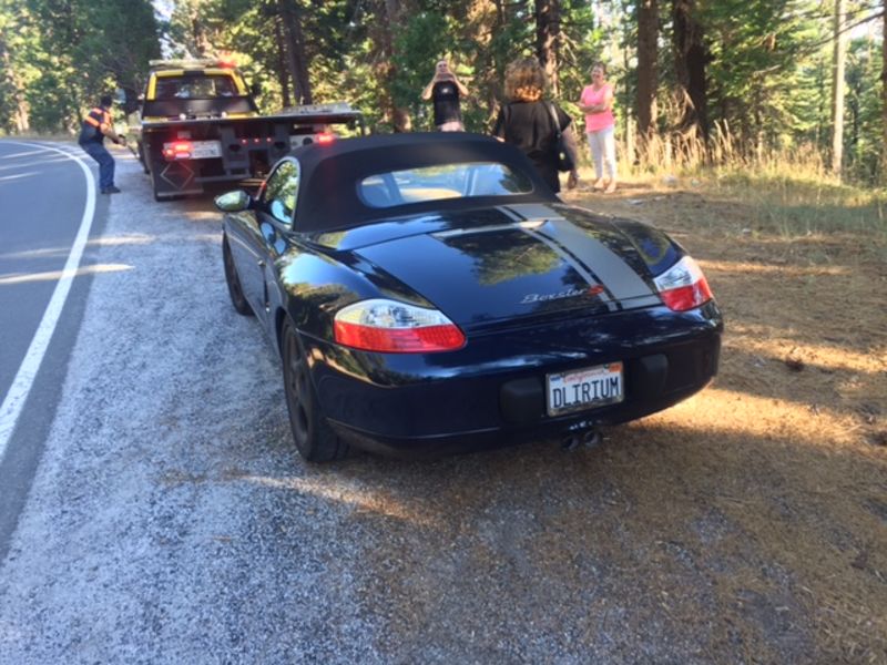

Took a nice drive up to Tahoe over the weekend, got to about 4000 feet going up hwy 88 and pulled over to check out the view. Got back in my 2000 S with 122k miles that has been running beautifully, and got the "crank - not start" thing.
I waited about 10 minutes and tried again - same thing. Waited another 45 min and tried. Still no joy. At that point I decided to cut my losses and call AAA. They took it the 170 miles to my house while I got a rental car and finished my vacation.
