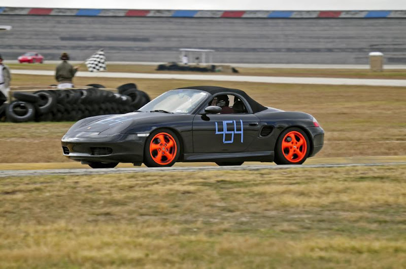

I am getting a spare set of rims, 17" OEM Turbo Twists and wondering how they are colored and what process/paint works best for a color change?
What are the options for changing the color?
Powder coat?
PlastiDip?
Krylon Spray paint?
Polishing to mirror finish.
I have been considering two tone pattern of some sort where parts of the rim are left in the Silver tone and other areas are polished to mirror finish.
Any interesting ideas or pictures of colored rims.
Its my spare racing set that I will be coloring.

After looking at a bunch of Rim Pics I think the two tone color combos are best on a black car when straying away from silver or chrome.
Amber rims to match the headlights

It really depends on your budget, and if you want the color to last. Powder coating would be the most robust but most expensive option. Painting them would be second best, but you have to avoid rim cleaner with painted rims, it's too strong and will damage the finish. Not sure about PlastiDip, but they do make plastic wheel paint that can be peeled off at a later date.

I just plastidipped my track wheels and it was easy peezy

PlastiDip is an easy way to try out a new color. If you don't like it, peel it off and try a different color.
My intention with PlastiDip was to do my wheels and see if I liked the color. If I did, the plan was to have them powder coated.
That was 3 years ago. The PlastiDip still looks great, so I've never bothered to get them powder coated.

PlastiDip is your friend. Cheap, easy, removable. I just did my second set of racing wheels in gold just to see what they look like.
Once you like a color and want it to be permanent, I had my wheels professionally painted and finished. I chose paint over powder coating due to the high temperatures required for powder coating (didn't want to heat cycle the wheels).
