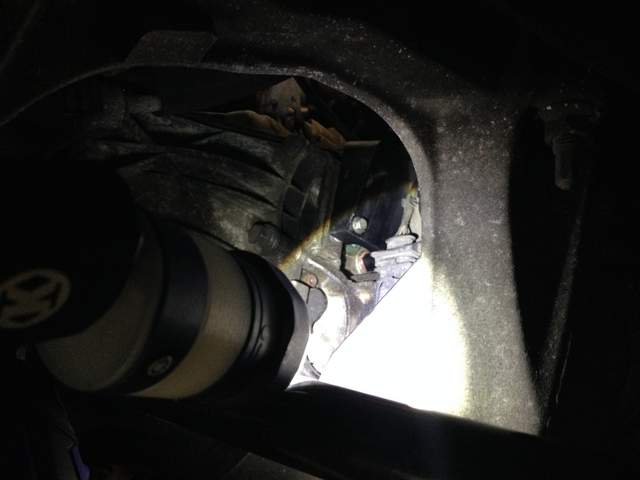

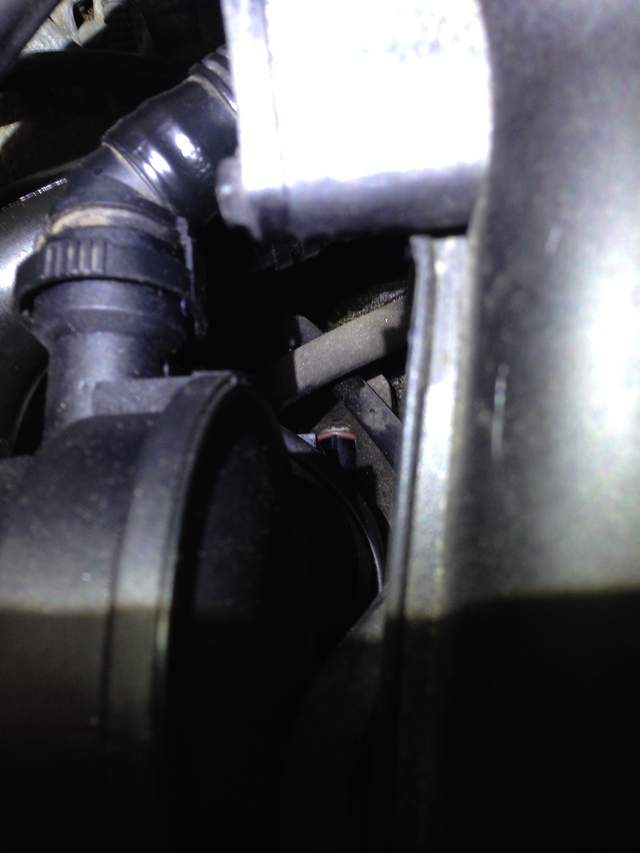

Thanks for your suggestions. Picked up some MAF cleaner and will do that shortly. Rechecked the connections. I do see something that looks like it could be an issue? I see a red rubber o-ring on the lower "input" next to the 2 bolts. I don't remember seeing one of these outer rubber o-rings on the old one. Does this look right in the images below?
I am wondering if (A) that could somehow be the o-ring that belongs inside and it didn't slide in; (B) that should not be there and I should reinstall without it; or (C) it is correctly installed.
Any thoughts?

Some "good news" in that, as you could see in the first picture, the one AOS tube at the top was not seated correctly. A refitted and it took care of the slightly rough running. But not the loss of power. I still get the sense it is a loss of suction. Not sure where though. I looked around based upon the helpful suggestions but could not see anything additional jump out. Could it be the lower "input" I reference in my post below? Also, I will repost the pictures as they seem to have sized oddly.

Reposting... I do see something that looks like it could be an issue? If you have a look at the pictures in my prior post below, there is a red rubber o-ring on the lower "input" next to the 2 bolts, visible when installed. I don't remember seeing one of these outer rubber o-rings on the old one. Does this look right in the images below?

My red rubber seal looks like that as well peeking out a little, but I am also having the hesitation and wandering idle.
I got my replacement AOS from Pelican but I did a smoke test for air leaks and nothing is getting past that red seal so I think its fitted perfectly.

Also, I cleaned the MAF and re-fitted the AOS. I was able to get the red o-ring farther in, but not completely as I imagine it may have stretched due to being in the prior position. Am thinking of changing the o-ring entirely just to eliminate the variable - a royal pain.
