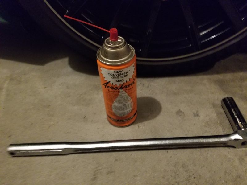

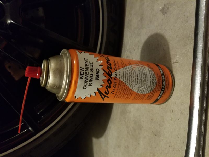

Get a can of Aerokroil and liberally spray it around the edges of your lug bolts. Let it sit / soak for 24 hrs. Then use a 19mm long socket on a breaker bar.
All of these items can be purchased at an auto parts store if you don't have them. Remember, it isn't a project unless you have to buy a new tool.
