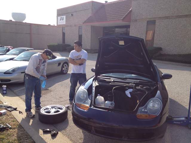

Several of us got together yesterday to flush ours. It was pretty obvious that mine had not been done in some time(I just bought it last summer). It would be worth it to do, just to know you have fresh fluid.
