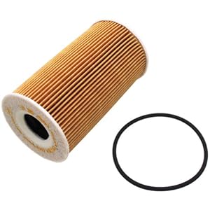

If you don't want to switch to the spin on setup, look at the Wix/NAPA Gold replacement cartridge for the OEM filter; same media as the Wix spin on in a filter with molded on end caps and a support cage that totally eliminates the issues that the OEM unit have with the exception that oil can still totally by pass the filter because of the design of the OEM plastic housing.

FYI unit pictured is the same plastic construction as the Porsche part, don't know if that is because it's for a 9A1 but the mahle is the same too.
The Mahle oil filter with paper end caps.......................
If you cut the unit you pictured open it too has a plastic inside. I'm sure the anal retentive Germans have done due diligence on the NAPA. If Mahle was suffering a severe loss in market share because the design they used was causing engine failure, would they not update? Would Porsche use filters they knew would ultimately cause engine failure? For sure the NAPA is a great product at a great price point, the difference using either product over time is about as important as which vacuum cleaner bag you choose. Frequency of oil change and filter change is the most important factor, period! Reduce the mileage in the change interval and use whatever filter you want.
