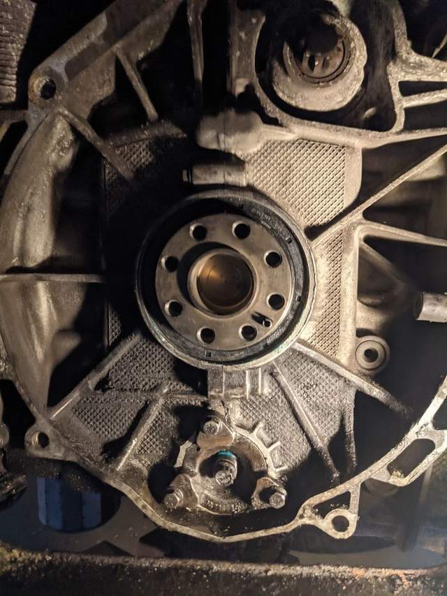

For the past few years my '03 Boxster has been leaking oil from between the engine and transmission. Last year it lost about a quart over 6 months of driving. The car has 235k miles but is in good shape and drives well.

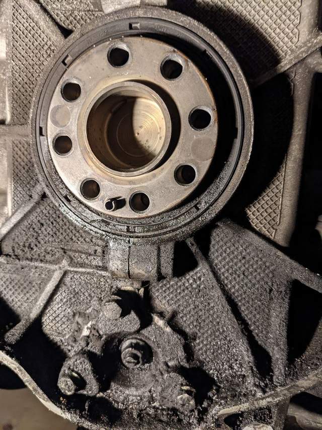

I decided to tackle the oil leak this week and suspected it was the RMS. I pulled out the transmission and removed the flywheel. The RMS has a newer 997 part number and looks like it might be leaking a little, but not a lot. Meanwhile the IMS is caked in oil.
I was not planning on addressing the IMS because I figured after 235k miles if it was going to fail it would have already failed.
Two questions I would love some help with
1. Does this look to you like a leaking IMS?
2. What would be the most cost effective way for me to fix this leak?

It looks like both the RMS and IMS seal are leaking. If you are certain that you don't want to replace the IMS bearing, you can just replace the flange seal. I recently did it on a high mile engine that I got with a parts car and it was easy to do.
Here's the seal at Pelican: https://www.pelicanparts.com/More_Info/99610511201OEM.htm?pn=996-105-112-01-OEM&bt=Y&fs=0&SVSVSI=1052
To replace it you should follow the IMS retrofit procedure up to the point of removing the flange. Do NOT try to just unbolt and remove the flange. I'd recommend following this: https://imsretrofit.com/wp-content/uploads/2017/10/IMSR-Pro-Manual-03-23.pdf
***You will need a tool to lock the cams and new cam plug.***
Another "while you are in there" thing to consider is removing the outer seal of the existing IMS bearing. That way you can inspect it and leaving the seal off lets engine oil lubricate it better (or so I've read). You can find discussion on that and decide if it's a good idea for you or not.

I agree with 78F350 on the IMS flange and bearing seal.
I would have expected to see more oil in there given the quantity that you report losing. Seepage could account for what you see. It would seem that the IMS is seeping more than the RMS but the RMS is not that difficult when you have it in front of you... and it is not very expensive

In good news I've made a lot of progress on this repair. New IMS bearing and RMS is installed! I also put on a replacement flywheel, pilot bearing, clutch and pressure plate. And I've prepped the transmission for reinstallation with a new slave cylinder, throwout bearing, clutch fork, clutch tube, and pivot pin. So many new parts!
When I took the IMS cover off the seal was brittle and falling apart. No wonder it was leaking! The cover is the newer style, so the IMS must have been serviced at some point in the past. The bearing I removed felt tight and did not need to be replaced but no harm buying that piece of mind. The bearing I removed is the same NSK model as in the new Pelican Parts kit, although manufactured in Poland vs. the new one made in Japan.
Looks cleaner than before too
