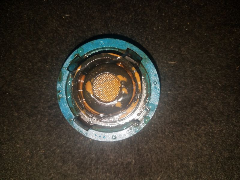

Well, looks like I have other issues. Since I am waiting on parts I ordered from Pelican. I gave the old girl a detail. Looked in the coolant reservoir and saw milky stuff. Yup, oil in the coolant. I know this can be multiple things, but is there a known issue on these boxsters? Here are some pics of the brownish milky residue in my coolant cap and reservoir.
Also, what seems to be the reservoir overflow tube hanging under the right front part of the engine was leaking coolant everywhere after a test drive.
MPDano is offline   Reply With Quote

I did that with mine shortly after purchasing. Your coolant cap isn't sealing properly and when the coolant gets hot it overflows and drains through that little hose to the ground.

The oil cooler is the obvious place to start. If it were my car I'd simply replace it.

Oil cooler is the best case for oil in the coolant because it's the cheapest and easiest. Cracked head will get you there too. I've also seen threads on accidently pouring oil in the coolant as the caps are so close. Browse this forum and you will find a lot of information. Head gaskets typically don't fail in these cars so that would be a long shot.

As far as the over flow you noticed, the coolant cap can cause that to happen. Failed or If you cross thread it not tight enough, can cause some issues.

It's definitely tight as it's not leaking in the trunk. I'll replace the cap anyways. Good call.
Was thinking this too, but I would think clean oil wouldn't turn dark brown like that. Hence why I thinking of intermixing.

If this were mine I would not throw an oil cooler at it. I'd drain the coolant, flush the system a couple times with distilled water, and then run it up to 185 degrees with distilled water only to see if the oil returns. You'll have to watch the temp as water does not cool as well as water coolant mixture. If the oil stays gone then you have the data point that it appears to be the last person contaminated the coolant. If it comes back. I'd remove the oil cooler and pressure test it with air before buying a new one.
2003 S manual
Old 05-10-2018, 11:25 AM   #19
I'm with James - before you start throwing parts at it, do a pressure test of the coolant system. That will help to identify where the problem is. If the test points to the oil cooler, then remove it and pressure test it.

I went and bought the Harbor Freight Cooling Pressure tester. The black adapter worked perfect. Put 12 psi (cap pressure) and it held with no leaking. I even removed the oil cap if that makes a difference.
Is it possible I just have a bad cap and the PO put oil in the overflow tank by mistake?
What are your thoughts guys?
