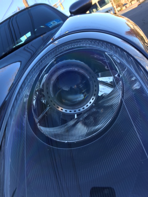

I chose the Mini H1 Projector HID Retrofit. It does require DIY work but totally worth it in my opinion. I am finishing mine up today. In progress pics.
BTW, Fred's design and execution look great. As a DIY you appreciate more of his work once you bake open the lights
