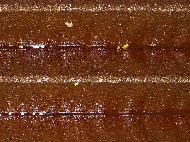

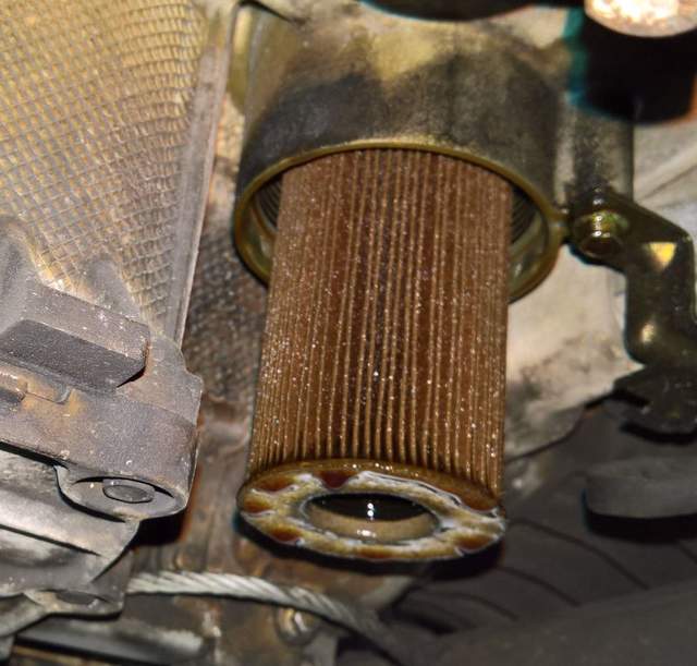

Pulled my filter cover off and drained it because my dash gauge also showed all bars lit. Thought it might take care of it like the OP did. While I was doing this I took a pic of my filter an it looked like it had shiny bits in the pic. I removed it and put a new one on because I wanted to see what it was. Ended up it was just the flash making the oil sparkle. I cut open the old filter and this the only thing (besides some dirt) I found in it.
Oh and my dash gauge still has all bars lit.

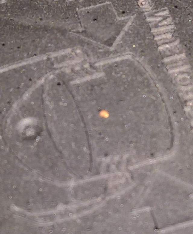

This is the largest piece of whatever that was in my filter. No metal in the oil, used magnet. This looked like a piece of sand but I think it may be plastic. Picked it up with tweezers and it desolved with minimal effort. Water pump fan piece? Seems to be off white in color. Should I be concerned?
Thanks in advance
Thanks in advance
Thinking of emptying out another cartridge full of oil tomorrow and see how that effects the dash oil gauge. Any opinions on stuff found in my oil ⤵⤵⤵
07-14-2017, 05:07 AM
#35
Posts: 6,683
Normal............
