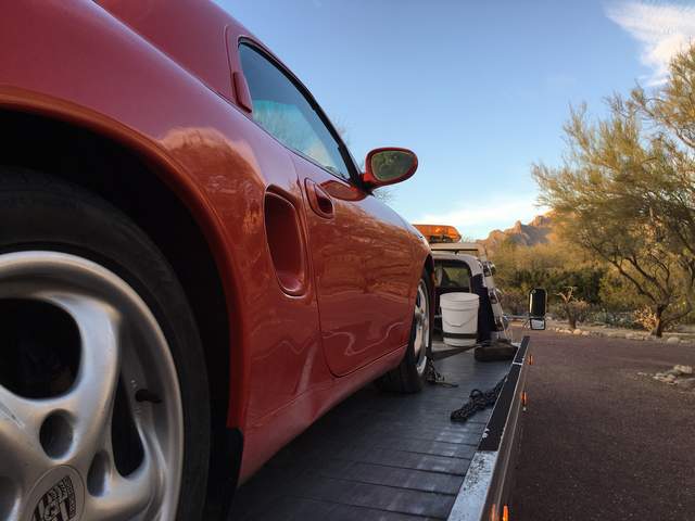

Ok, here are some of the first pics, including a video of it starting.
Here it is getting loaded up:

tada is offline   Reply With Quote
