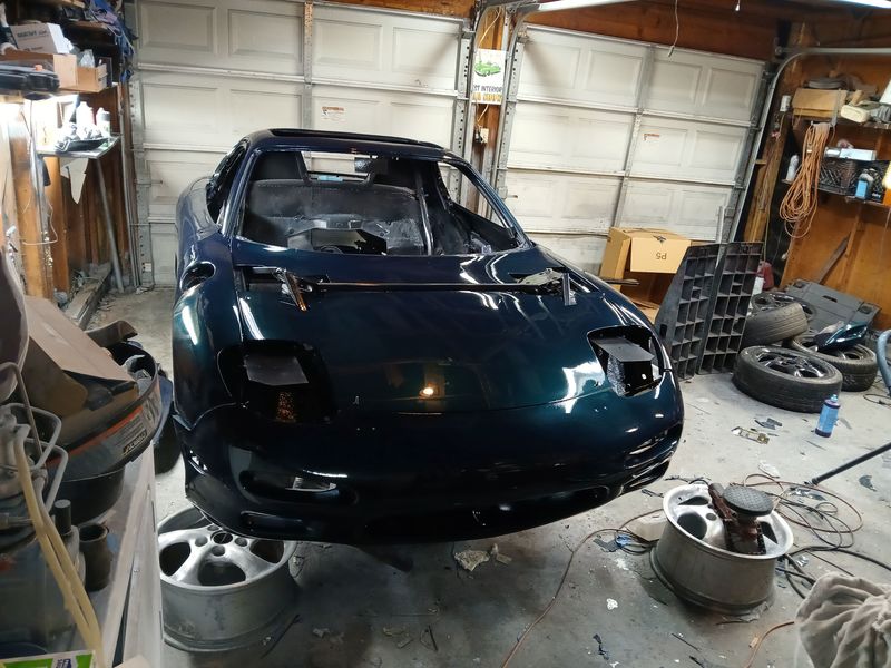

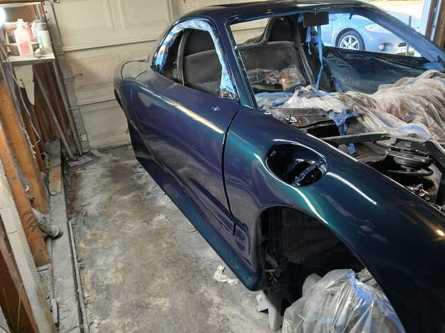

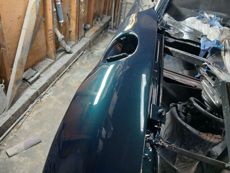

Damn flow coating does wonders... Smoooooth

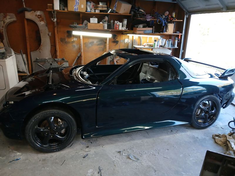

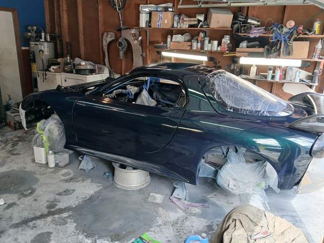

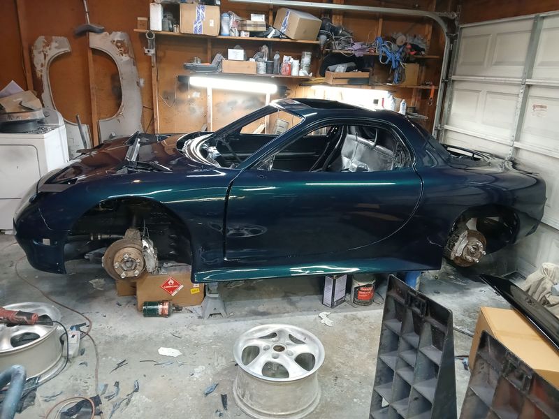

I had to play "dress up" LOL

That is looking good. I hope my paint work improves this time, assuming I ever get out of the bodywork stage. Did you delete the door handles?

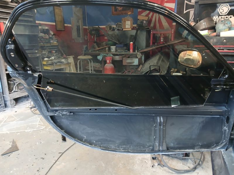

FD door handles are on the little black area near the windows.... And they were a common fail point from day one. Meaning today they are expensive.
Also, I don't have space for a latching mechanism in my "doors". The doors on here are just skin. There is a small latch I welded in that holds the doors closed, but its accessed from inside the car only.
I won't be able to put the windows up and close the doors, but I'm not concerned about that in the slightest. The car is garaged and my job is so far from anything else relevant nobody is gonna mess with this thing. Oh man I just jinxed myself. LOL
On the topic of windows. They aren't really going to roll up... more like I'm just gonna have pegs I put in them to hold them up while I'm using the A/C and driving.
Try flow coating your paint. It makes a terrible paint job... ok. After your clear coat cures (like 3 days) run 1000 grit over the whole area. Get the clear completely smooth, but DO NOT go into base. Then toss on 2 or 3 more coats of clear.
Your gonna paint yours black? Color sand the crap out of it, and let it shine.

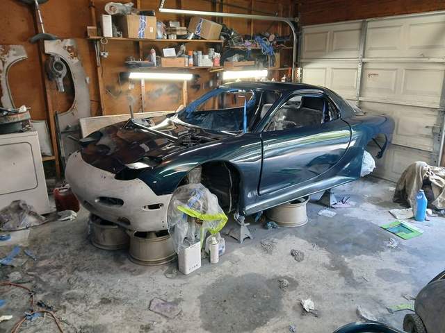

90% done with the body work UGH

Looking very good
Thanks, I'm hoping that it'll perform well too.
I can't wait to test its metal on an autocross circuit. Then I'll truly trust the chassis. Figure thats the safest way to watch this thing fail. LOL

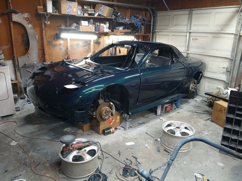

All I have left is to make a moon roof, readdress the starter, readdress the alternator, get and wire lights, fix the left rear wheel bearing, set the ride height, and rebuild the engine.

- fit the shifter nob.
- respray the bumper and some odds and n's
- make plexi windows and the plexi firewall
- remake the intake manifold
- make an air filter box
- felt cover the roll bar covers
- cover the steering wheel (its grey and doesn't match the tan look)
- mount and wire the backup camera
Lots of other parts that were questionable before need to be purchased and installed. Seat belts, E-brake, master cylinder, etc...
I'm still hopeful I'll have it street worthy by years end. Money is kind of the problem now. I kinda overspent on the paint and body pieces, but they look nice

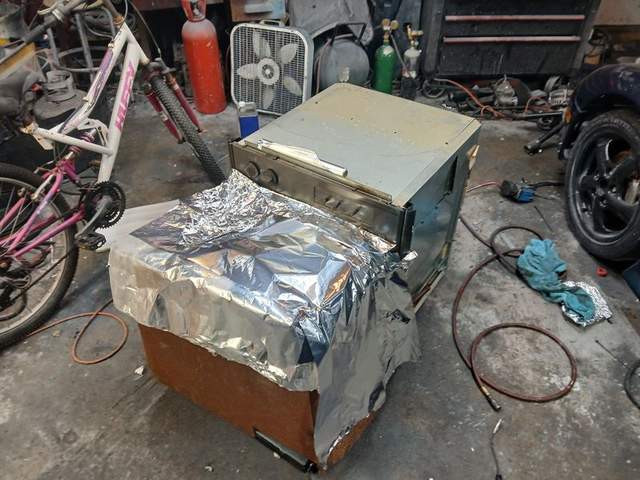

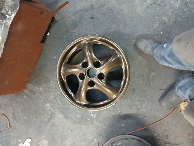

Powder coated wheels "bronze". The package stated its bronze, but I'm seeing brown.
The oven I got was not big enough so I made it big enough. LOL

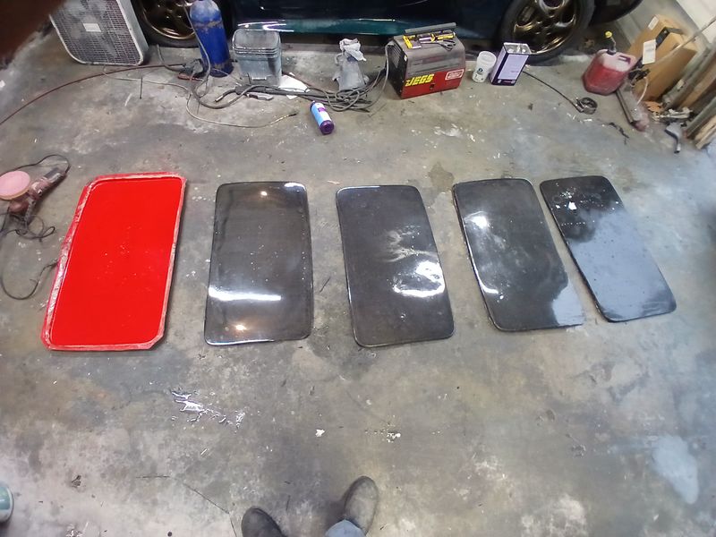

Made a carbon fiber moon roof. Well, I'm learning, but still need a few more trys to make it good. This will do for now.

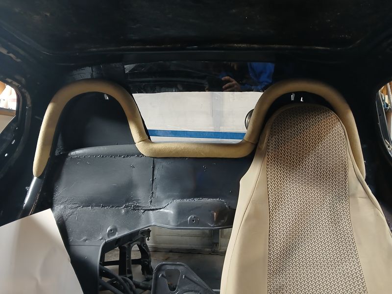

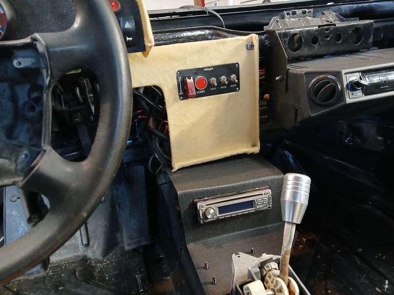

I made windows and improved the interior. I covered the roll bar pieces.

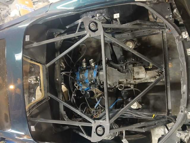

Finally I reinstalled the engine/trans.
