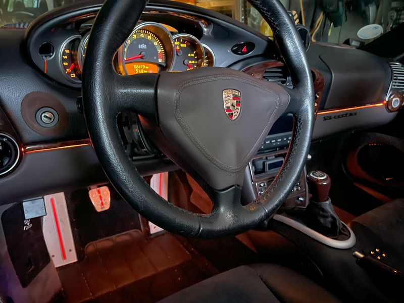

A new project on the horizon! A found by chance two interesting things, which I always wanted, ever since i got my 996 instrument cluster:
1.) That instrument cluster had a broken clock shaft/knob from the beginning and was declared defective. And Porsche offers no replacement. So I created a workaround, which worked "okay".
And then this headline caught my attention: "Finally sort out that annoying broken trip or dimmer knob on your 996 or 986 Boxster!"
2.) I always wanted to individualize my center tachometer gauge face, but could not find ANY I liked.
And then I stumbled across "gaugefaces" and we created the following retro inspired, but modern Porsche 911 looking face together:
So I have 2 good reasons to tackle that instrument cluster job. Not really looking forward to it, as it is a fiddly job.

After changing the tachometer face, the tacho needle is dead silent.
Not exactly sure, when it exactly happened, probably when trying to (very) carefully lever up the needle.
I then changed the strategy to twist the needle counterclock wise, and then it would come off "pretty" easily.
Which hurdles did I take:
1.) Opening the case without damaging electronic cables, braking the plastic hook or damaging the plastic outter case.
I invented a new way to open the case, as I saw a lot of people failing at that step. I drilled a super tiny hole, so that a bend paper clip can pry open the plastic hook inside the case. Works like a charm.
2.) Removing the needle. I probably failed here like most others. I guess the ONLY way to go is to turn it counterclockwise and carefully lift it off. I tried to carefully lever it off first, but noticed, that this is NOT going to work, as MOST youtube videos try to tell you.
3.) Removing the metal ring, which secures the gauge face. Very delicate work! I carefully removed the top ring, braking tiny little bits off until the decal came off. It is a perfectly round part to center the new gauge face, still.
4.) Putting the needle back on. Again turned the needle counterclock wise and pushed a little, untill I reached the original spot of the needle.
I am an expert now, when it comes to detaching/reattaching the gauge cluster, opening/closing the gauge cluster case. I do all that in under 5 mins, now. lol
And I replaced the broken shaft stalk.
Drawback: I need a gauge cluster repair shop for the tachometer, now, I guess.

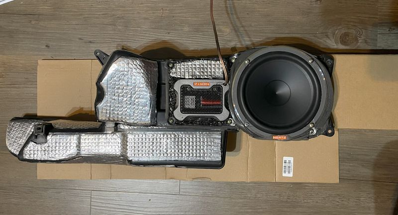

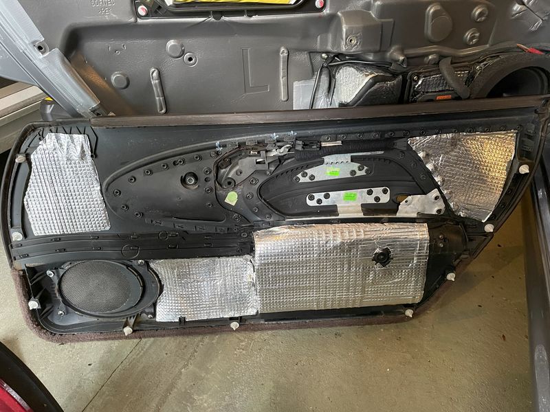

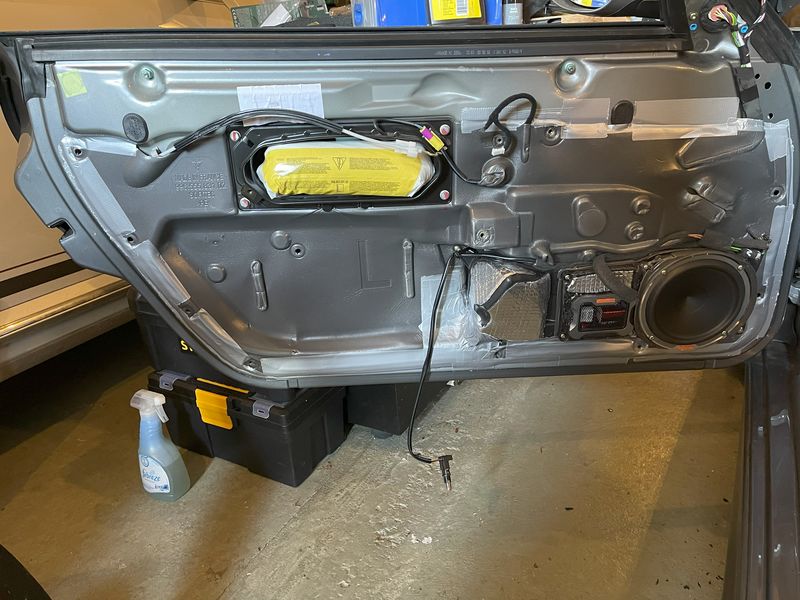

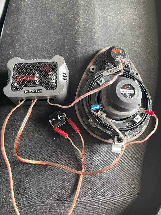

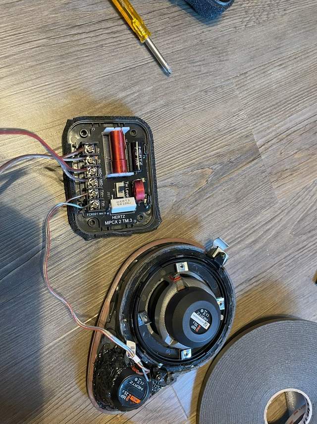

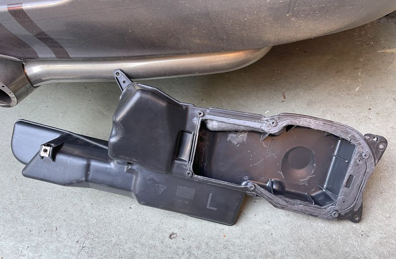

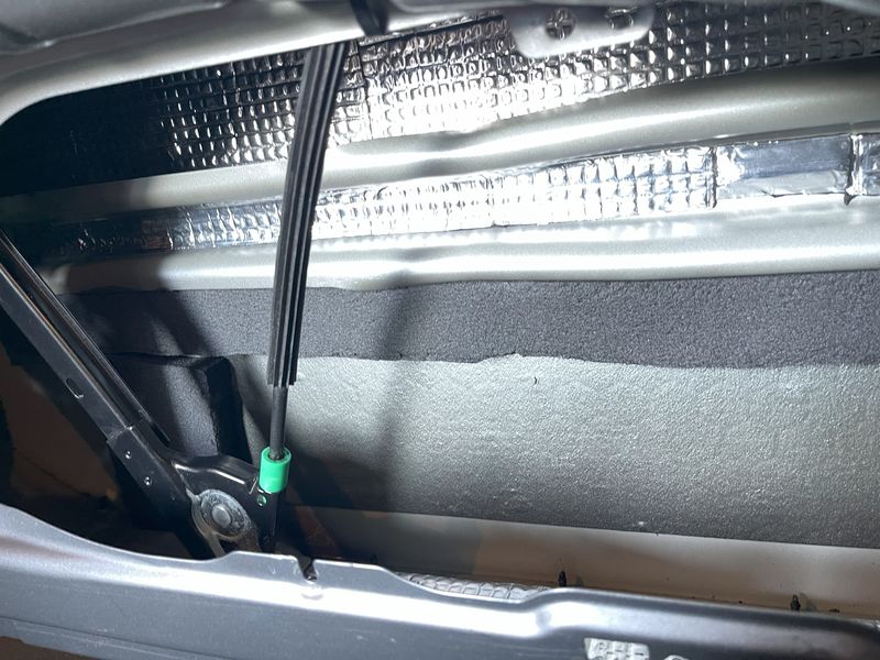

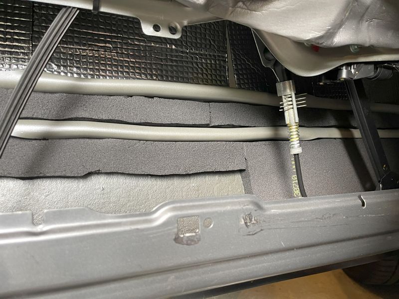

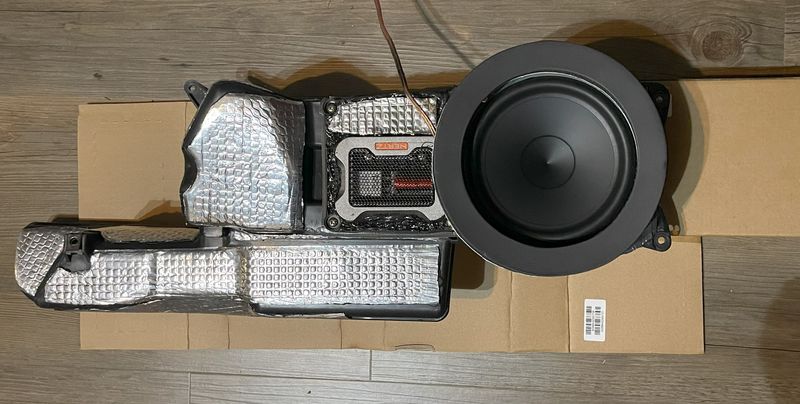

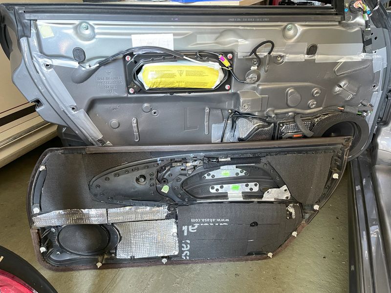

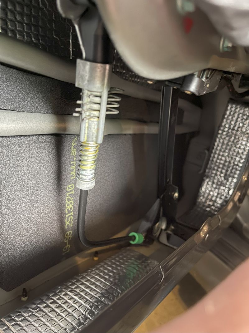

From a coaxial speakers mishmash (JBL and infinity) to a 3-components speaker set from Hertz MPK 165P.3 (3 ohm woofer + 4 ohm mids and tweeters).
Sound damping the doors (wherever possible/usefull) was priority #1. Actually, there was a little alybutyl installed by Porsche already.
Sound damping the subwoofer frames was priority #2
Sound damping the door carts was priority #3
Maybe a little over the top

Did you check if the VAS of the Hertz speakers corresponds to the relatively little volume (i think it*s about) 5 litres of the door speaker enclosures? Result might be a relatively high resonance frequency.
And: there is no overdamping of a speaker housing walls. Maybe at some point you have a weight problem.
Old 05-06-2025, 11:47 AM   #594
WALDMEISTER
BRAN's Avatar
Location: Germany
Posts: 1,381

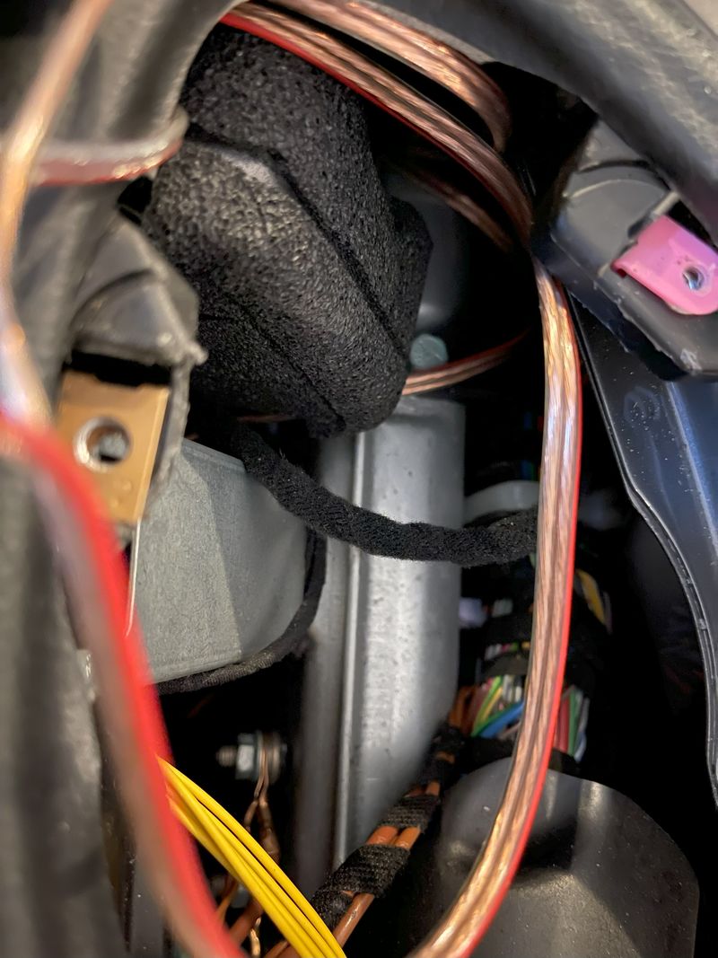

Yes, I did a little research and figured that most factors cannot be changed easily. So improving the factors I can change was my strategy: Damping damping damping
The bose cases have a volume of 6 litres. I gutted them completely of their interior and upfront plastic sound channeling. That possible gained a few extra ml of volume.
I moddified the speaker holding frames, so that they can hold the cross-overs and the woofers (extra distance layer). That possibly gained another few extra ml. The cases are still a closed system.
My mid/low HERTZ woofers => VAS = 8 l
Most other 6.5" woofers have a VAS of 10-13 litres. And going smaller, like 13cm...have max 4 l VAS.
They are (almost) perfect, but won't reach their full potential.
But that is fine.

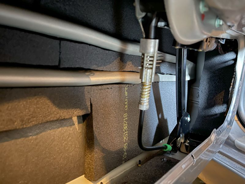

The extreme sound damping with alubutyl (first layer) and sound foam (second layer) ...
- inner doors
- door cards
- woofer cases
- upfront speaker frames
... plus the upgrade from Infinity coax speakers to a 3-way 4-channel Hertz MP165.3 Pro system (plus mini subwoofer) lifted my sound to NEXT LEVEL.
Was it necessary? Not really, but it was on my bucket list, just like the PCCM+
The doors make the most satisfying sound now, when they fall into the lock.

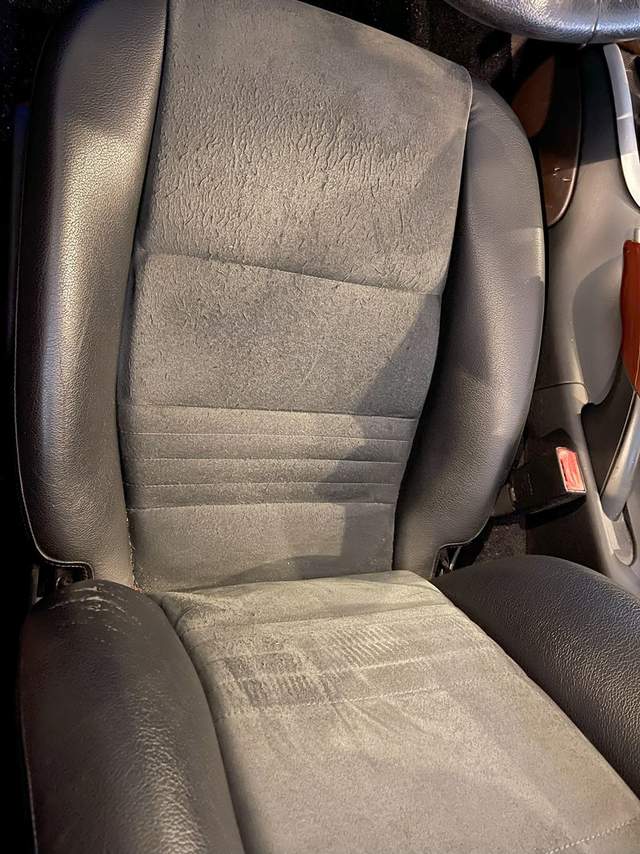

Finding used or new cocoa leather interior parts...it's getting more and more difficult.
Cocoa brown leather seat inlays/inserts are not available anymore from Porsche since 2025. What to do? My seats are 25 years old and could use some love.
2nd best option just popped up from Porsche: Original Pepita/houndstooth seat fabrics
I think I have another project on my list again.
