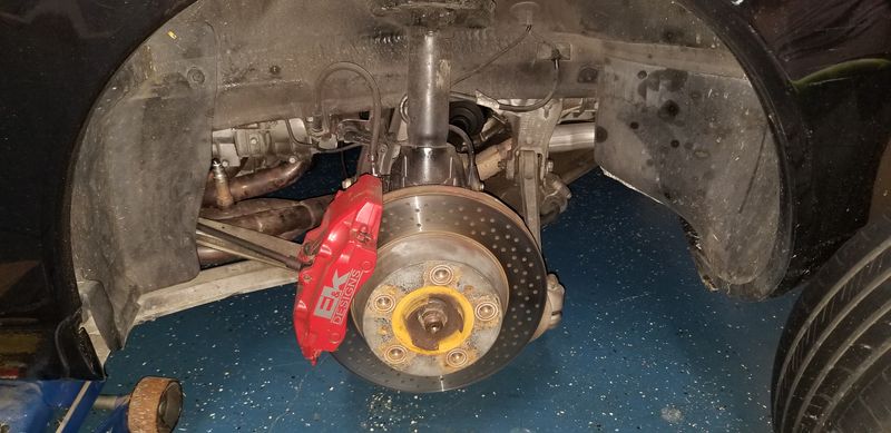

If just one, flip it to other side and see if issue follows wheel or stays w/ hub / wheel bolts (keep them true to side but if issue stays at orig location then flip them to see if issue is wheel bolts or hub/hat of rotor, etc.).

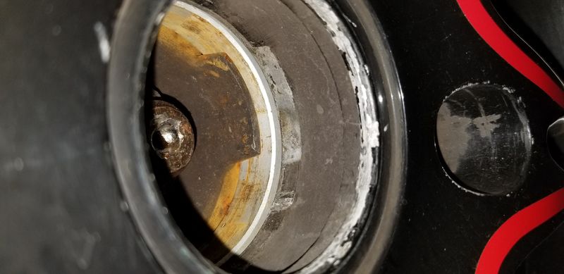

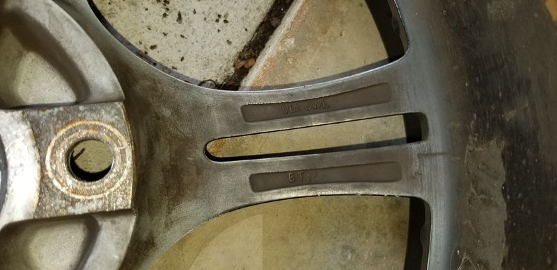

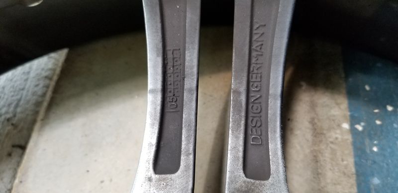

Also, pull the center cap and take a picture to post please.
And, take a picture of lug bolt head and wheel lug mounting surface. OEM wheels/bolts are spherical shaped. Many aftermarket wheel use conical, flat or mag... they do not mix. And finally measure your wheel bolt length... maybe there were spacers previously?
Wheels look like knock off of HRE wheels from same era.

I'm out of town. Best picture I have for now.

2002 Boxster S,headers,exhaust, wheels/spacers, speed humps, brakes, desnorkle

How big is the centerbore? (The hole in the center of the rim? Measure it on the back of the wheel, shld be about 71.6mm). If its larger than the hub, it would be impossible to center it correctly without hubrings.
Maybe the ring(s) got lost at the shop? Idk. You can check the other hubs or wheels to see if they have hub rings. Maybe one is missing on the problem wheel only.

Others have shown you hub-centric rings. These are essential. But yet more crucial are the correct bolt. 986 factory wheels use a ball-seat type bolt. Many aftermarket wheels use a conical seat. Others have a centering shoulder that goes into the lug bore. Still others have a flat washer captive on the bolt. They are NOT interchangeable.

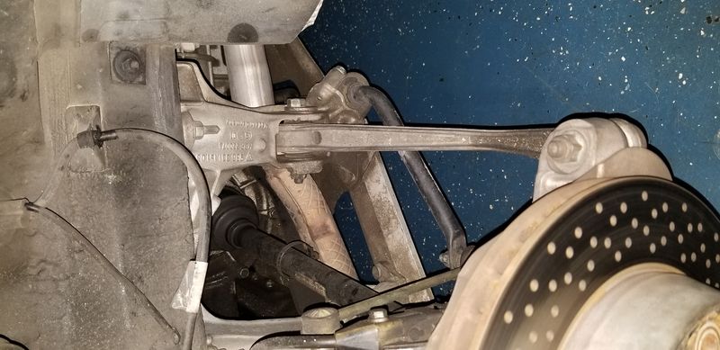

I'm still scratching my head about what actually broke, or bent, in the accident you described. What did you repair?

I use the same technique while cradling the tire between my feet. I think you hit the nail on the head as I was ordering an Alignment pin last night at 3:00 a.m. I noticed the ball style lug nuts. I have the beveled lug nuts. The cross member and upper control arm were bent and replaced along with a new 4 wheel alignment. I will be ordering a new set. I have spacers. What size bolts do you recommend
