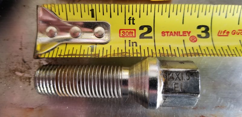

Also, pull the center cap and take a picture to post please.
And, take a picture of lug bolt head and wheel lug mounting surface. OEM wheels/bolts are spherical shaped. Many aftermarket wheel use conical, flat or mag... they do not mix. And finally measure your wheel bolt length... maybe there were spacers previously?

I'm out of town. Best picture I have for now.

Others have shown you hub-centric rings. These are essential. But yet more crucial are the correct bolt. 986 factory wheels use a ball-seat type bolt. Many aftermarket wheels use a conical seat. Others have a centering shoulder that goes into the lug bore. Still others have a flat washer captive on the bolt. They are NOT interchangeable.

Looks to me as if the spacer keeps the wheel from centering. I can see where it use to touch the wheel. When he gets home from work I will try mounting one without the spacer. I like the stance with, any suggestions?
