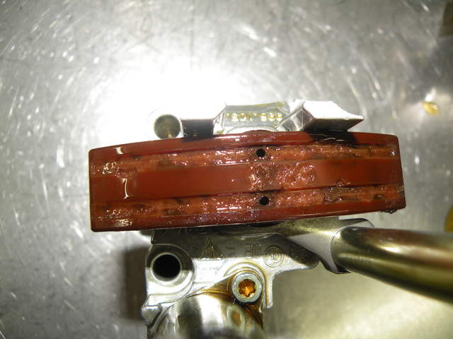

Funny, I just opened mine up to find the culprit of my -9 on one bank and was puzzled to see the first pad looking just fine. The I turned the tensioner over to see the 2nd pad and whoa! Looked just like that sucker in the picture!

This is what happens when people drive a Porsche like a Honda, or Toyota or Buick Skylark.. Easy driving keeps the VVT arrangement in the "loaded" position at all times and increases the forces these wear pads see.
Men can also drive like females, and they wear these components out way early as well. We have actually seen these wear so thin that they break in half.
Ha ha! That explains a lot! When I bought this car in the spring, the p o almost had a fit when I punched it on the test drive!
