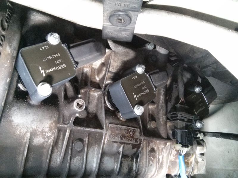

Story: Replaced AOS a couple months back, on the test drive Flashing CEL with P0300, P0301 ++.CEL. Stopped car CEL went out Cleared codes.
Last week 700 mile road trip, Got the Flashing CEL with P0300, P0301 ++, Again light went out no issues
Pulled Right side bank coil packs and low and behold - 2 of 3 cracked. I'm just replacing all 6 but what part number works????

This is what I was afraid of. I only checked right side coils and I didn't see any thing that would prevent using thicker body coils
I need to look at Left side to see if this pipe is there on Boxster. I now remember 1 coil being blocked from easy access

I had only pulled one bank and 2 of 3 were cracked
One had a crack into the body but both had cracking around the bolt hole sections
So the thicker design, I think, would be less prone to that. Otherwise I don't know if there is something electronic going on with the thicker
Also It appears a regular 8mm socket will work on these Torx bolts
