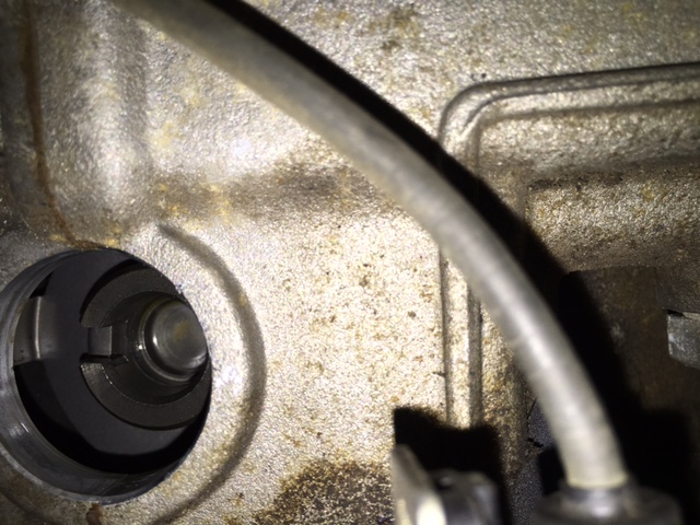

This is a great picture of the intake cam. Could you post a picture of the exhaust cam so to see if the notches are straight up and down?
See post:
DIY: Setting Cam Timing on M96

Maybe I missed it, but did you check the cam timing already from the link that "muscatty" posted?
The check is easy enough to do with the engine in.
Old 04-25-2016, 10:34 AM   #110
1998 Boxster Owner
Join Date: Feb 2016
Location: Tucson
Posts: 141
The timing on bank 1 was right on. I posted a pic of bank 2:

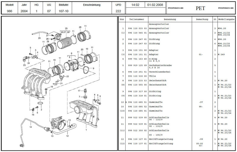

I'll replace them all if I could find that kit. I've searched for hours for the part number of the rigid vacuum line I need that goes from the intake manifold to the fuel pressure regulator. Porsche Atlanta shows it on a diagram as part 16, and then does not list it. Pelican has rigid vacuum line sold by the meter that is listed as 4.0 x 1.0 mm. If anyone knows the part number, I would appreciate it. Otherwise off to my local Porsche dealer.

Hello tada,
is the part you're looking for on the chart, or am i on the wrong chart. If it's on the chart, which number has it. Could you alternatively link to the chart from Porsche Atlanta. Than i can look for the parts number.
Regards, Markus

Thanks Markus and Gelbster. I was finally able to find the part number for the vacuum line - 00004320501. I appreciate the help, Tom.
