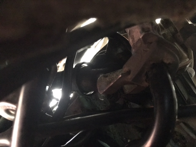

Thanks for asking. I'm still working on it. I ordered the parts last weekend and received them yesterday. I knew the middle tube on the AOS was detached at the crankcase vent valve in front of cylinder 4. So before I started the whole AOS removal, I decided to reattach this hose. I got my hands in there from below the car. I lined the "quick connect" vacuum line up with the fitting on the valve. I pressed and pressed the hose. I could never get it to go on. I examined a normal fitting and the hose off the car on the new AOS and J tube. It looked like what I was doing should work. But I can never get the leverage necessary to completely get that locking ring over the fitting. The only way I can see to get the necessary leverage is to remove the air box, which looks worse to remove than the AOS. I don't know if dielectric grease or even oil would help this hose attach to the valve. But I lost a lot of skin off my knuckles last night (through nitrile gloves) squeezing my hand into that air box area just to grip a small bend of the breather hose.
Tada,
I would recommend to lube the o-rings on the accordion tube as these are easy to damage when you are pushing trying to secure the locking ring.
Also, examine closely the accordion hose as a crack can be difficult to see, yet will have a vacuum leak and make a mess if left unattended.

Lucked out big time. I went through the firewall and was able to pull the breather hose a little tighter on the valve. Then from below I was able to finally push it hard enough to snap it closed. Attached is a pic of the valve and breather hose taken from the firewall side. It's a PITA to reach. But it's done and no air box removal needed.
While I was under the car I undid the middle hose from the AOS, undid the bellows tube (PO had obviously replaced the AOS before - had a radiator hose clamp on it), and unbolted it from the bell housing with a 1/4 ratchet and 10 mm socket. That only took 15 minutes. So the old AOS is out. I did luck out with the radiator clamp. Now to enjoy an adult beverage and clean things up. I'll drop the new AOS in in the morning along with a j-tube and try to fire it up!
Thanks, Tom
