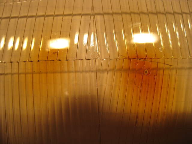

Norm, impressive. I presume this is the result of running those Porsche headlamps "day & night" (CA's DRL)?
I've retrofitted little over 50 of those BOSCH headlamps, maybe more dunno, and I've never seen them that toasted lol Ouch! Here in most cases they are simply yellowed with, in most cases, a very small crack...
Regardless, I'll have to take my words back... once yellowed I don't think there is any coming back for those things.

Originally Posted by clickman View Post
I have never used anything but stock output bulbs, and I still had the burning.
I installed Fred's projectors and killed three birds with one stone: got rid of cheap burned plastic, got the superior light output of the xenons, and hugely updated the look of the front end. In my case for under $400.

Old 10-23-2014, 09:58 AM   #36
No way, Charles. You took the blowtorch to those, right??
Hey Norm. Thanks for the references
The picture that I posted above is what happens when you use those stupid "HID White" blue bulbs. I've had a few sets that were this bad or even worse. One set was missing the entire middle portion of the lens...it was pooled up in the bottom of the reflector!
On top of that, the bulbs are usually blown up like a balloon because they got so hot that the glass melted!
I usually have some good inner lenses lying around. If I don't, I usually know who does

Old 10-27-2014, 02:33 PM   #38
Old 10-27-2014, 09:47 PM   #39
Nine8Six's Avatar
Posts: 3,249
wow... when you thought you've seen it all ^ unbelievable!
The whole car could have been toasted if this glass would have failed and made contact with that cheap plastic reflector thingny lol
