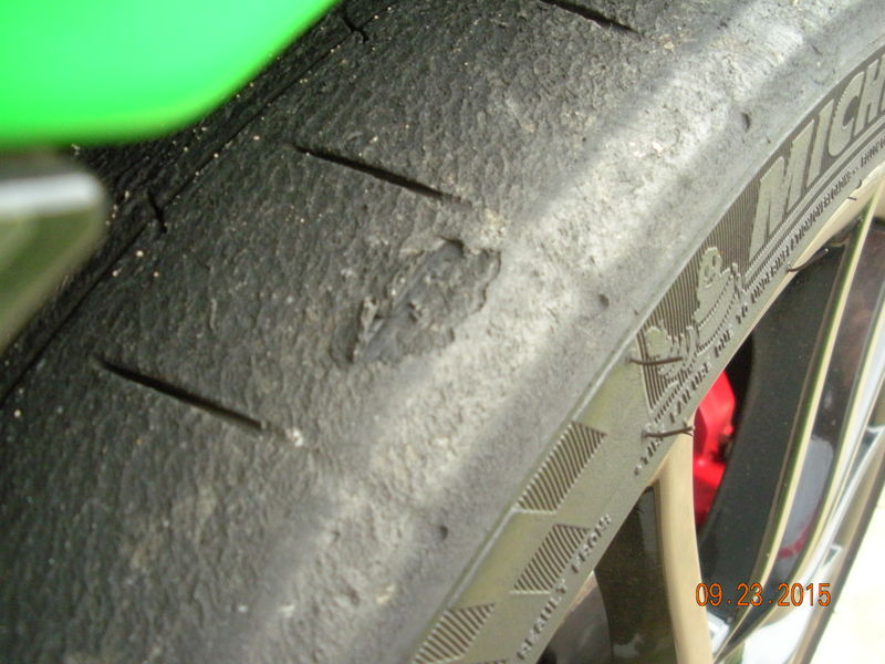

....it really puts a beating on the outer edge of those front tires during turning..... Otherwise you can really shread those edges and ruin the tire, while there is still plenty of tread left everywhere else on the tire.
Like this:

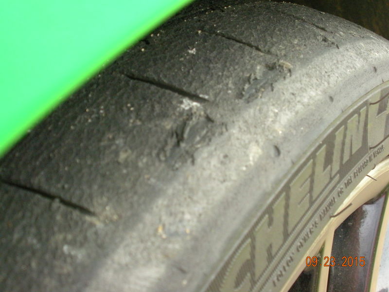

I now have GT3 LCAs on my CSS. -2.5 front, -2.1 rear (stock).
Before I had the LCAs, I had std alignment. Here's what my tires looked like with that alignment.
Surprisingly enough, the insides of my tires are not too bad now with all the neg camber.

Or this:
Old 02-08-2019, 09:08 PM   #13
Another example of excessive tire wear from insufficient camber - outer edge of the tire down to the cord in ~250 miles.
