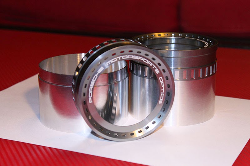

Below is a picture of your kit before it left. Souvenir
Looking forward your pics and further development mate

Below are similar to Ray's above but with black skirts. For those who wish to paint the interior of their headlight black.
Finish is polished & anodized gunmetal. The bezel's laser script is custom "as per customer's requirement".
This is now the official "Standard" kit i.e. replacing the flash silver painted bezel.
Shoot me a PM if you are interested in retrofitting your Porsche Boxster (or 996) headlight from halogen to high performance bi-xenon projectors.
