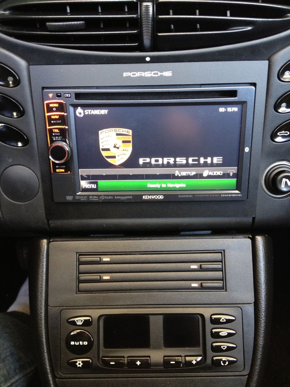

AFTER TWO WEEKS OF WAITING!!!!
Got everything installed today. All I can say is... wow. The difference between this and the chinese unit... It's not even comparable (well... considering how this one was 3x the chinese one).
Where to begin where to begin. First, let's re-assess why I returned the chinese brand GPS:
1. The GPS was sketchy. It would take forever to load and wasn't very logical. It also lagged. You couldn't see the streets half the damn time, and if you ever exited the GPS, you couldn't get back into it.
2. The Bluetooth was murky. You couldn't hear me half the time. Phonebooks and contacts were not synced. It was basically a telephone on your car, where you'd have to memorize the number, couldn't see who was calling, and they couldn't hear you anyways.
3. The menu was slow, laggy, and un-intuitive. It also wasn't very pretty.
4. The Bluetooth music sync wasn't also very compatible with my iphone. I could play, pause, and go next track or previous track... That was about it. Perhaps the most glaring problem was the fact that the music would cut in and out, depending on where you iPhone was. If it was in your pocket, the music would lag every few seconds!
5. The included ipod cable, although allowed me to play music, didn't charge my phone.
Now let's look at the Kenwood.
1. The GPS is Garmin. It is fast, reliable, easy to use, and even has updated traffic and street view.
2. The Bluetooth is CRYSTAL CLEAR, EVEN WITH THE TOP DOWN ON THE HIGHWAY! Phonebook is synced. I can go through my contacts, recent calls, and even tells me who is calling when I'm getting a call.
3. The menu is lightning fast, beautiful, and easy to navigate. There's no lag, and no frustration trying to go through the menus.
4. The bluetooth music is complete. I can browse my playlists, songs, artists, etc. It shows my album art, and there is absolutely no lag between songs or during songs. Everything is crystal clear and perfect.
5. The ipod cable (another $30) was able to charge my iphone. Something I was very happy about.
But that's not the best part!
I can use my iphone apps through the Kenwood screen. I can even play youtube videos from my phone on the screen. How amazing is that?
Granted, you're paying 3 times as much, but it is sooooooo worth it. This is coming from someone who has tried both. I would say go for the Kenwood hands down. It's only another $400, and it is worth every penny and some.

I'm glad you got the unit and features you wanted in the Kenwood.
Install looks great.
I did not have the problems you experienced with your Chinese unit and honestly I'm not even using most of the features of even my unit.
Its working great for what I need it to do, GPS Navigation, Play music from DVD and USB, and the backup video.
I think if you want to use most of the functionality then the Kenwood is the right one to install.
My next upgrade will be to something more resembling an Ipad with WIFI etc as DVD's and CD are virtually obsolete now.

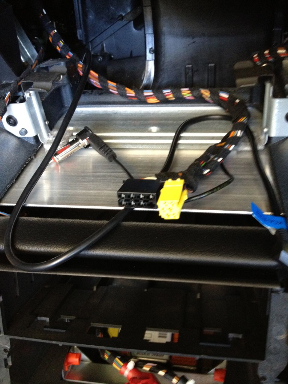

Thanks for that. I have just installed the amp, routed the cables into the cabin and swapped the dash speakers. Will do the head unit over the weekend.
I have the Pio SGH-DA100 AppRadio which is quite light as it has no optical drive so I am not too worried about sagging but I will find some way to support it other than just the cage.
The secret, (if there is one!) is to put two screws through each side (holes already in cage) and into the plastic dash part just the same as the more expensive kit.
I did this - and added a couple of washers between frame and cage to prevent distorting the plastic frame.
This makes it very rigid and will never sag nor rattle.
You just need to mount everything up on the bench to get the distances right, then fix it in place within the plastic frame.
David
So did you use the cage that came with the Connects2 kit, or the one that came with the head unit?
I was thinking the Pioneer cage will fit the unit 100% but OTOH the Connects2 cage may be better adapted to the car.
My car has the one piece "horseshoe" vent frame and I am not sure what is the best way to remove it but I suspect is is just using clips.
Yes, I used the connects2 cage as the bezel has clips that need to fit to the cage and on my Kenwood it would not fit properly as the cut outs were not there.
You just need to juggle (on the bench) the side mounting clips so that you get the distance correct - ie the distance from front of head unit to flush with bezel.
Its easy when you see it on the bench, rather than trying to describe it.

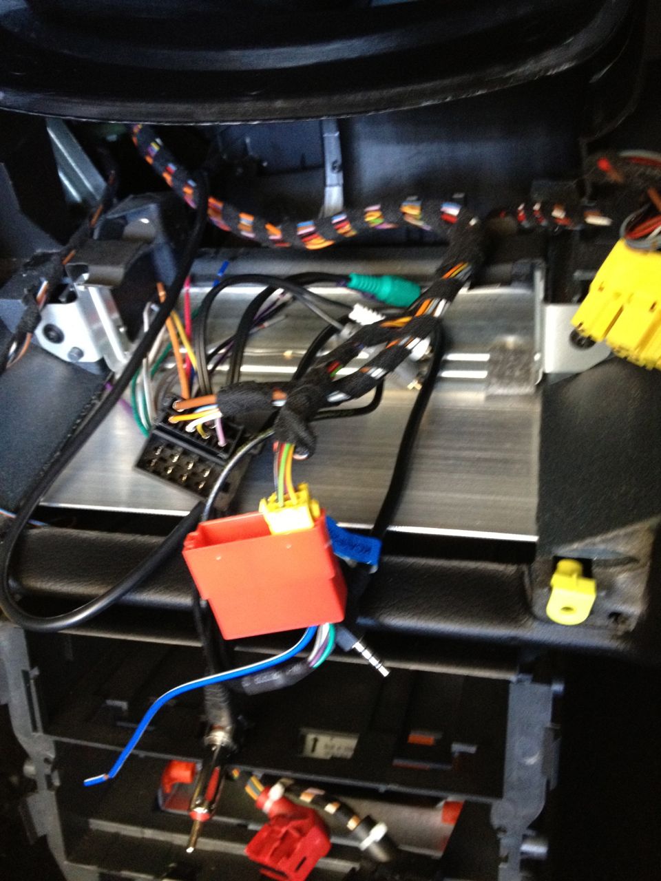

Got it. Final question - where did you take switched power for the head unit, and how did you connect the parking brake/reverse leads?

Originally Posted by Gforrest2 View Post
+1 That's where I got my switched power.
I took out the a/c unit today and there are a LOT of wires on those two connector blocks. Which one is the switched 12V supply? Green/black?
Probing them all with the ignition on and off will take ages...
Did you put a tap on the wire or did you cut and splice?
