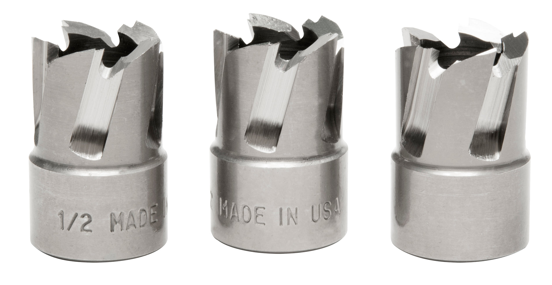

If you are thinking about using this for the bell housing slot for the IMS Solution oil line, let me make a suggestion: WIth just the new flange set loosely in place, make the bell housing lip location with a marker, then drill a small pilot hole to start, increasing the bit size until you are at the opening size needed. Then trim away any excess material first with a fine hacksaw, and then clean up and bevel the edges with these bits.
My preferential method is to use a rotary broaching tool once the pilot hole is in place. The broach is basically a very accurate hole saw type tool that makes a very clean hole of the right size in one move, but is rather exensive for a one time DIY:
I considered drilling and hacksawing, which I'm sure can provide a decent result. However, I have some experience grinding metal from working in a body and fender shop, and I want to try the right-angle drill and burr method. The same method was used in Jake Raby's video demonstrating how to install the Solution, and it resulted in a pretty nice notch after a minimum of thrashing.
I do like those broaching tools. My metal-fabricator friend has what he calls a broaching set, but it doesn't include anything that looks like that. They're expensive, you say?

A set of metric or SAE common sizes from Blair/Haugen is about $75 on Amazon; larger sizes can get a bit more expensive:
I'm a sucker for new tools, but as you say, they wouldn't be cost effective for a one-off by a DIYer. Still, I might come across (or invent) other projects for which they would be the perfect solution, so I'm glad to know about them.

They have a lot of automotive uses; if you are faced with creating an opening in a metal panel, say a bulkhead, for a wire/cable or tube to pass thru something like a firewall or bulkhead, drills tend to "pull" on the metal, distorting it, which often requires going to a hammer and dolly to beat it flat so that a cable gland can seal it weather tight again. Rotary broach tools cut a flat, undistorted opening of whatever size is required in a single move, just run a deburring tool around the hole and install the cable gland and you are ready to make a weather tight pass thru with minimal time and efffort.
Dang. 2 days ago, I’d never heard of these, and now I gotta get me a set!
Conceptually not all that different from the holesaws I use in carpentry and much quicker than what we used back in the day, which were Greenlee knockout punches (drill a pilot hole, thread the two halves of the punch together thru the hole, and then pull the two halves together).
