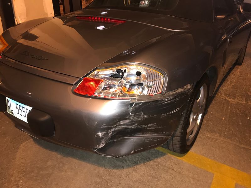

Hey there, so.. after 3.5 months of owning my Boxster, someone passed a STOP sign and hit me.. Insurance says that i must find the guy who did it, else i will pay for repairs. I got hit on the rear left(drivers) side, and unfortunately it hit not only the bumper but the wheel also. In the pictures you can see some broken "wheel" things such as broken control arms etc.. Result is that the car couldnt move, since the wheel was almost disconnected from the car...

Different insurance rules in Europe is my guess. Have you filed a police report? USA insurance companies require you to report the crime to authorities to help cut down on fraudulent insurance claims.
That looks like quite a hit. Are you okay? Beyond the obvious damage, is the trans okay, will the car still track straight?

I think that is repairable, but I would have a shop check to see if anything is seriously bent before starting any repairs. At least you did not get hit, but it is unfortunate you have to find the person responsible to get the repair covered. I agree with the other estimates of about $3-5k USD, the biggest potential issue, besides any extensive bending, is the rear quarter panel which is welded on. Hopefully, they can pop that panel back into place and match the paint.

Yes. As far as I can see I’ll need:
Rear bumper: About 600euros + 250euros to paint it.
At least 3-4 arms for the wheel with sum of: 1500€ maybe?
If something more serious is bent, then it will be much bigger sum... Then maybe some other things have been bent on the wheel, the brake arms or so?!
Plus at least 10hours to fix them, of 1000€ at least I guess..

The first job is to get the car either onto a Porsche supplied jig which allows physical measurement of the straightness of the frame. Or some shops have the ability to put the car into a rig that uses lasers and compares to a data base. Once you know what frame and suspension mount damage there is, you can begin to assess the wisdom of what approach to take in fixing the car.
Wheel connects to axle shaft connects to transmission/differential which displaces the engine which ...

suspension components are cheap and if the cv joint is ok, then its just a new boot.
Probably less than $500 for the suspension on that corner.
A bit of work on the quarter and a new bumper and it wouldn't be so bad.
Just make sure the chassis is not tweaked

What MikeFocke said. ANY rear end hit to a rear engined car can cause all sorts of problems. Also, if you were hit hard enough, it is possible the monocoque frame can be displaced... $$$$$ ask me how I know...

UPDATE: Just got reply from the dealer... Parts & labor for the broken stuff: $5000
*But* this is not final cost, since they must put the car on racks, once assembled, and check if it’s straight or not. If it’s not straight, then more costs to be added... I.e suspension...

My car was put on the rack before any work was done and the results of that test were what ultimately determined if it was to be repaired or sent to a breakers. There are two ways of measuring, a physical measurement using a Porsche supplied jig and a laser machine comparing results against a data base. My accident repair estimate on the front (driveable) that I mentally calculated at $3k based on prior vehicles was over $26k done right at a shop that handled Ferraris and other $100k+ cars.
When I look at the suspension damage you had it is much more serious in its implications than mine was. Forces sufficient to wipe out the suspension on one side could transfer all the way to the other. And affect suspension, transmission and engine mounting points on the chassis which are the items you want to know about before bothering with the suspension. After all, there are rear ends from any Boxster in a breakers yard that could be totally swapped in for almost trivial costs IF the suspension mounts are true. The cosmetic stuff is just that. It is how everything will mount and if the crash protection during the next accident that you worry about. Good luck.
