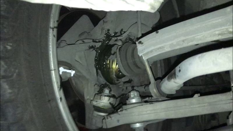

Hey there, so.. after 3.5 months of owning my Boxster, someone passed a STOP sign and hit me.. Insurance says that i must find the guy who did it, else i will pay for repairs. I got hit on the rear left(drivers) side, and unfortunately it hit not only the bumper but the wheel also. In the pictures you can see some broken "wheel" things such as broken control arms etc.. Result is that the car couldnt move, since the wheel was almost disconnected from the car... :(

Fix on shop 100% and maybe on Dealer... My insurance will cover this if I knew who hit me ( or if that guy didn’t run away). Anyway, unfortunately dealer told me I will have to pay about 3-4K euros... But maybe it’s more ?

I think that is repairable, but I would have a shop check to see if anything is seriously bent before starting any repairs. At least you did not get hit, but it is unfortunate you have to find the person responsible to get the repair covered. I agree with the other estimates of about $3-5k USD, the biggest potential issue, besides any extensive bending, is the rear quarter panel which is welded on. Hopefully, they can pop that panel back into place and match the paint.

Yes. As far as I can see I’ll need:
Rear bumper: About 600euros + 250euros to paint it.
At least 3-4 arms for the wheel with sum of: 1500€ maybe?
If something more serious is bent, then it will be much bigger sum... Then maybe some other things have been bent on the wheel, the brake arms or so?!
Plus at least 10hours to fix them, of 1000€ at least I guess..

The first job is to get the car either onto a Porsche supplied jig which allows physical measurement of the straightness of the frame. Or some shops have the ability to put the car into a rig that uses lasers and compares to a data base. Once you know what frame and suspension mount damage there is, you can begin to assess the wisdom of what approach to take in fixing the car.
Wheel connects to axle shaft connects to transmission/differential which displaces the engine which ...
Quadcammer 12-31-2017 01:30 PM
suspension components are cheap and if the cv joint is ok, then its just a new boot.
Probably less than $500 for the suspension on that corner.
A bit of work on the quarter and a new bumper and it wouldn't be so bad.
Just make sure the chassis is not tweaked

I don't know Euros But in 2010 I was hit by a Durango. The injuries look a lot the same It cost $14,300 US dolars at the end. I'll see if I can find the photos. The Original quote was $9,600. They found more as the repairs went on.
$8,139 Parts
$3,316 Body Labor
$952 Mechanical labor
$1088 Paint labor
$72 Frame labor
$13,567 total labor and parts
$814 PA Tax.

Axle, Right Quarter panel, Toe link, Inner fender parts, Trailing arm, Control arm, Bumper cover, Bumper cover liner, Paint. They use the frame kit from Porsche to verify the frame. Paint and materials.
The original Quote was less than half the replacement cost in 2010 the car listed at $20,999 KBB so we fixed it. Had they known the actual costs they would have scrapped it. My guess is it won't be practical to repair.

What MikeFocke said. ANY rear end hit to a rear engined car can cause all sorts of problems. Also, if you were hit hard enough, it is possible the monocoque frame can be displaced... $$$$$ ask me how I know...:eek:

I was referring to the pictures posted by another member. Mine was basically a direct shot to the mid/right rear. Your's doesn't look quite that bad, but these cars can get some significant damage under all the surface stuff. I wouldn't give up just yet. Get a comprehensive estimate done by someone that knows these cars. You will prob have to pay for it, since you seem to be stuck insurance wise, then you'll need to decide. Getting a shot that snaps control arms is pretty significant and most likely caused damage all the way up the line.
Lacostas 01-11-2018 10:41 AM
UPDATE: Just got reply from the dealer... Parts & labor for the broken stuff: $5000
*But* this is not final cost, since they must put the car on racks, once assembled, and check if it’s straight or not. If it’s not straight, then more costs to be added... I.e suspension...
Any input ?
mikefocke 01-11-2018 11:16 AM
My car was put on the rack before any work was done and the results of that test were what ultimately determined if it was to be repaired or sent to a breakers. There are two ways of measuring, a physical measurement using a Porsche supplied jig and a laser machine comparing results against a data base. My accident repair estimate on the front (driveable) that I mentally calculated at $3k based on prior vehicles was over $26k done right at a shop that handled Ferraris and other $100k+ cars.
When I look at the suspension damage you had it is much more serious in its implications than mine was. Forces sufficient to wipe out the suspension on one side could transfer all the way to the other. And affect suspension, transmission and engine mounting points on the chassis which are the items you want to know about before bothering with the suspension. After all, there are rear ends from any Boxster in a breakers yard that could be totally swapped in for almost trivial costs IF the suspension mounts are true. The cosmetic stuff is just that. It is how everything will mount and if the crash protection during the next accident that you worry about. Good luck.
