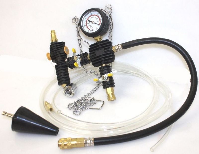

What model Airlift to get?
I'll jump in on this thread instead of starting another. Similar problem. Just changed the tank and thought all was good. 100 mile drive to the track with no issues. On the track with lots of runs to 6k rpm, I'm losing coolant. I think air is stuck in the system still, but either way, I am buying the tool. Don't need a pro model, but not looking to get the cheapest. What do you recommend?

I have used a cheapo EBay one and it worked fine. The biggest challenge is making sure the compressor has the capacity to do the entire refill w/o having to pause while it rebuilds pressure.
The tool works on a Venturi principle and by design squanders a huge volume of air. It isn't so much a pressure issue as a volume one. At the shop we have a huge tank -so not an issue.At home I have a much smaller one so it gets tedious.
And of course you need a very large bucket/bowl/baby bath in the trunk with more than enough coolant for the entire refill.
Yes, you can use the valve to stop and start but unless you are quick and careful you will get a slug of air entrained in the suction hose.
There may be a better way?
There is. While we use the Uview system, we added an extra shut off valve on the coolant pickup line, which allows you to "pre fill" the line before actually starting to pull coolant in. This eliminates any air entering the system, and also allows you to stop the process at any time, like to add more coolant and distilled water to the 5 gal pail we use to hold the mix.

Thanks, Here's one that is not a direct copy of the uview, but looks fully functional. I wasn't planning to go this cheap, but at about $40 I think I'll give it a try, unless you guys think its junk. Uses 12cfm air supply, so probably need my 60 gallon compressor instead of my little 5 gal.

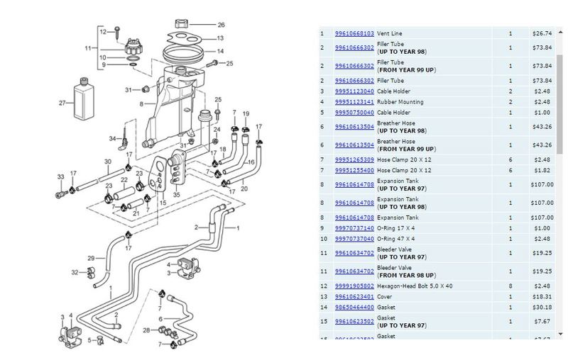

if i read JFP right, he meant that option 1 is replacing the whole valve assembly (part 11 in the diagram) Vs replacing only the O-Ring (part 9)
i wouldn't go and replace the whole tank if it is not leaking.
very expensive part, and very hard to replace.
You are correct. More often than not, trying to repair that valve or replace the O-rings comes to grief. So while replacing it may not be the cheapest approach, it is the one with the least chance of coming back to haunt you.

The large O-ring in the coolant bleeder valve was bad. There is a strange crimp in it that is likely from initial assembly, I don't think it has ever been apart. It is unbelievable that it ever provided a proper seal. The fuzz in the picture is from a rag.
It was a 15 minute, $5 job to remove the valve and replace both O-rings. Now my tank holds pressure and the coolant level only moves from mid-tank to 3/4 tank from cold to hot.
