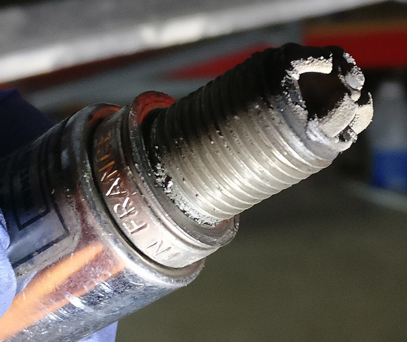

As I speculated earlier- plugs will tell the story
Old 05-28-2017, 09:32 PM   #11
Join Date: Jan 2013
Location: Houston
Posts: 370
Finally got able to pull a plug. #6. This looks more like ash deposits from fuel. 13k miles on the spark plugs.
