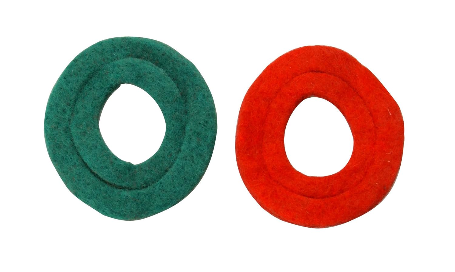

For what it's worth, and you may already know, but simply putting a Fluke on a battery does indicate its status.
I assume Autozone put a load tester on the battery, and gave you the OK on it.
I had a similar problem on an old Ford van a while back.
The battery terminals were not making good contact.
No visual signs of corrosion on the battery posts or lead clamps.
Just enough dirt/oil/time had seeped between the post and clamps to make the system shut down.
Hit it with electrical cleaner, wire brush, and placed the red & green chemically infused battery felt pads and never had a problem again.
I put those impregnated donuts on all of my batteries.
https://www.amazon.com/989-Anti-Corrosion-Washers-2-Pack-12-Volt/dp/B000CQFS0O/ref=sr_1_fkmr0_3?s=automotive&ie=UTF8&qid=1475327305&sr=1-3-fkmr0&keywords=battery+corrosion+preventative+donut

I have used the battery donuts for years. They are cheap insurance.
