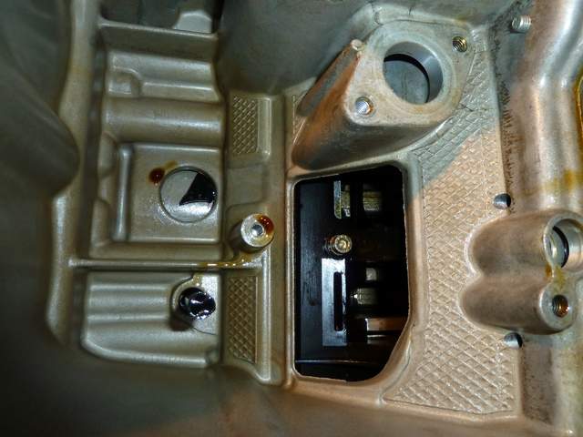

Sweet success!!
Can see it sticking it's ugly sharp head out of the round hole. Forced air from shop vac did the trick. :dance:

Nothing beats the huge sigh of relief when you work your way out of a pickle like that, nice job.

When wrenching "there is no substitute" for patience and relentless persistence, good job. Case looks like a convict under hack has been on it with a toothbrush and polish.

you all can probably imagine my state of mind. I was so happy when i saw the plastic piece stick out of the hole. This car is a love hate relationship. Just when you think you want to part it out it crawls back under your skin again!
