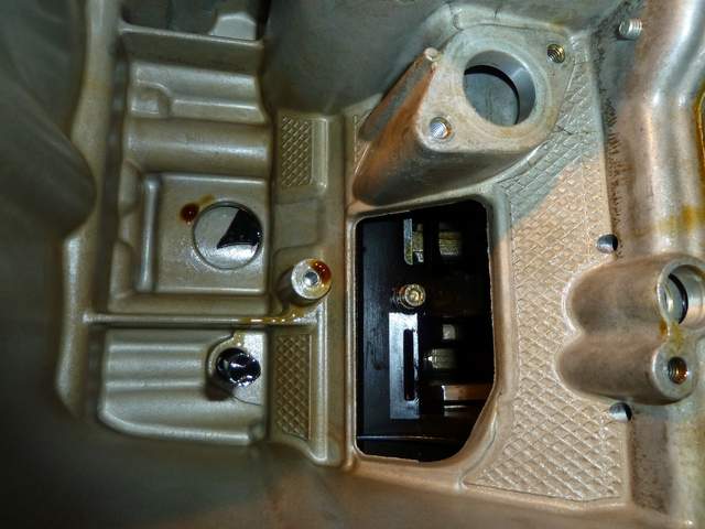

Bala 03-21-2012 04:27 PM
Sweet success!!
Can see it sticking it's ugly sharp head out of the round hole. Forced air from shop vac did the trick. :dance:

Botoxster 03-21-2012 06:22 PM
Originally Posted by Bala (Post 283500)
Nothing beats the huge sigh of relief when you work your way out of a pickle like that, nice job.
Ghostrider 310 03-22-2012 04:36 AM
When wrenching "there is no substitute" for patience and relentless persistence, good job. Case looks like a convict under hack has been on it with a toothbrush and polish.

Bala 03-23-2012 03:38 AM
Guys,
you all can probably imagine my state of mind. I was so happy when i saw the plastic piece stick out of the hole. This car is a love hate relationship. Just when you think you want to part it out it crawls back under your skin again! :D
