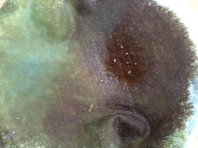

We just caught this one. The customer called me saying there was a bad noise coming from the bell housing.
I told him to not run the engine any more and then went to get it with my trailer.
I just got started, but look what I found in the filter:
