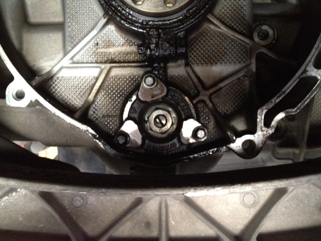

We just caught this one. The customer called me saying there was a bad noise coming from the bell housing.
I told him to not run the engine any more and then went to get it with my trailer.
I just got started, but look what I found in the filter:

In the pan:

Bad news. The engine has been previously replaced and this bearing isn't serviceable.

Sorry, I should have been more clear. This is a 2003 911.
The engine was replaced at 67k miles with an IMS failure. This is number two for this vehicle.

Why isn't the bearing Serviceable. Not disputing...just have never heard of that before.
Newer designed bearings require splitting the engine case for removal, older / original IMS bearing designs could be removed with a puller while the motor stayed intact / assembled while in car. Man, 2 motors kaput in a 911, that'd be enough for me.
