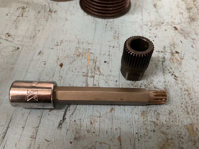

Here they are...
To remove and install you need these tools, I think they are standard for Bosch alternators.
Grant
