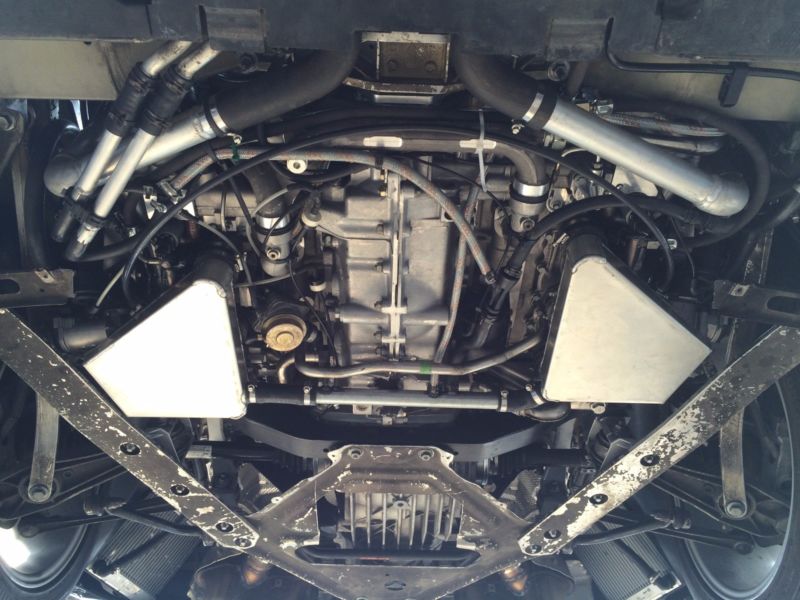

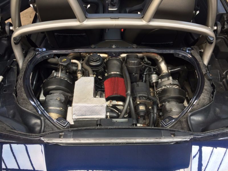

This is a highly modified M97.90 Mezger Biturbo engine of a 997.1 Turbo in a 987.
More Infos: http://986forum.com/forums/518873-post246.html
Regards, Markus
Regards, Markus
Interesting. That took a bit of effort. Not sure they have any chance of getting €167k.
