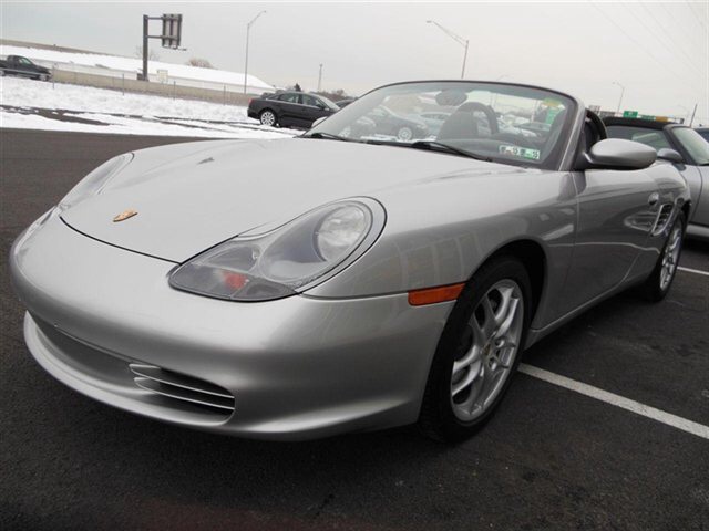

Nice looking car. I think you made the right choice. Your in the ARPCA region check and see who they use.
